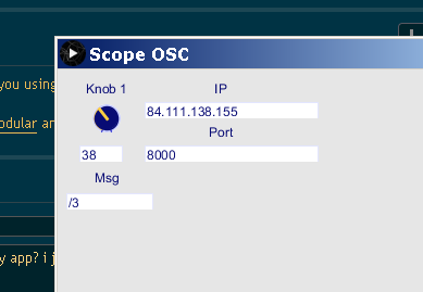

will thought more about it, your way is probably the best option. i kinda dislike the idea of really long message addresses but i can't think of anything better than your proposal.
i restarted from scratch on my little app. better code. now i have text fields on the front panel for ip and port, works :)

oh i didnt notice damn! grabbing now man ty! do you wanna test my app? i just added also the ability to set the message for the knob :)
