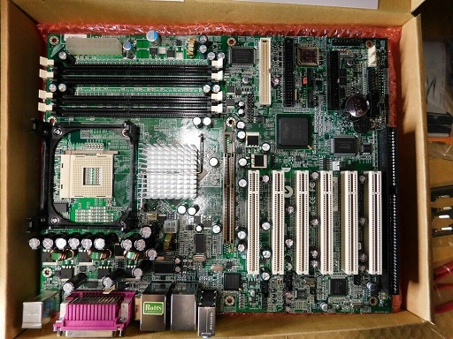

Just built another XP machine to run scope and it's been amazing.
BCMCOM Motherboard, Socket 478
P4 3.0
500 watt PSU
4 GB ram
GeForce FX6200
240 GB SSD
Been running great for past week, and I just added another Pulsar card. 8 DSP's of fun, no complaints. :)
Also, those motherboards are available still, NEW, motherboard/CPU combo. I found a seller on ebay and it was $120.
It has:
1 AGP
6 PCI
1 ISA
The ISA and 6th PCI are shared.
Re: Definitive Scope PCI card host PC?
Posted: Tue Mar 23, 2021 5:00 am
by valis
Nice looking board.
Posted: Tue Mar 23, 2021 12:20 pm
by astroman
absolutely - didn‘t know there were P4 boards with ISA slots... so thank you @PlanetZaxxon .
Just browsed the manual and it seems a better alternative than the old Asus P2/P3 boards on my target list to eventually get the HardSID Quattro (ISA) up and running. It’s been sleeping for ages in it‘s box on the shelf.
Posted: Tue Mar 23, 2021 4:22 pm
by PlanetZaxxon
Yes, me either! this was the first I have come across I believe, P4 with ISA slots. I love ISA slots, for some Sound Blaster 16 action, heh.
Posted: Tue Mar 23, 2021 7:01 pm
by Bud Weiser
PlanetZaxxon wrote: Tue Mar 23, 2021 4:43 am
Link ?
Which RAM does it support ? RAMbus ?
Posted: Wed Mar 24, 2021 4:10 am
by PlanetZaxxon
It is the standard SDRAM, DDR400. 1GB max per slot.
Just shoot an offer for $120 and he will accept.
https://www.ebay.com/itm/NEW-Intel-Sock ... 2749.l2649
