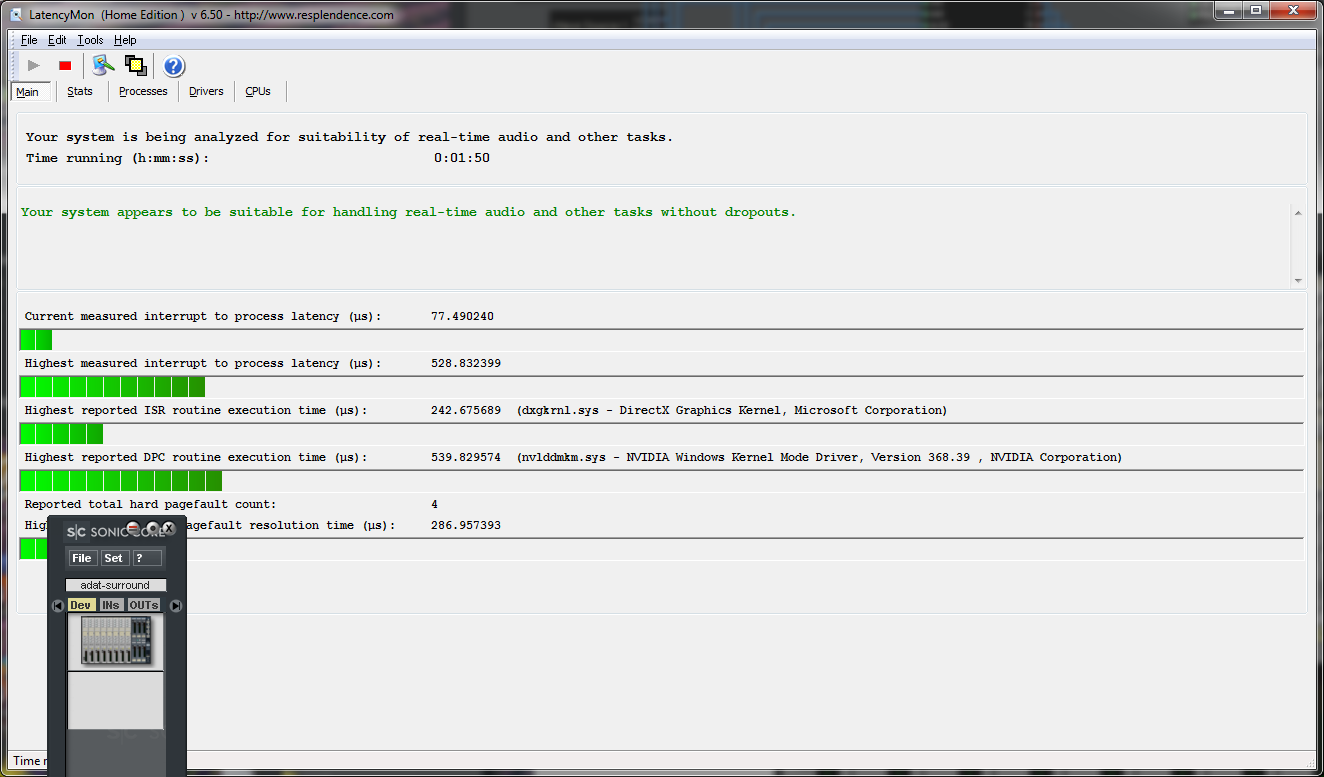

Testing using LatencyMon. A16 connected to ADAT-A:

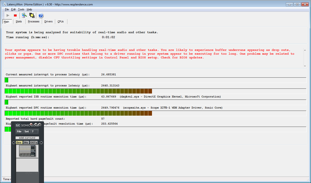

And here connected with ADAT-B:
The troublemaker seems to be scopexite.sys!

Hmmmm.... re-install Scope drivers? Check for duplicate Scope files? Don't see this being done in the thread.

Besides I've already installed Scope on a virginal system (with same behavior): question why are ADAT-A and ADAT-B different (i.e ADATs on A16)? A16's ADAT-B is fine (up to 48k), but A only at 32k. Cable have be swapped and also crossed. Result: whenever ADAT-A from A16 is connected to Xite, trouble starts at 44.1.
