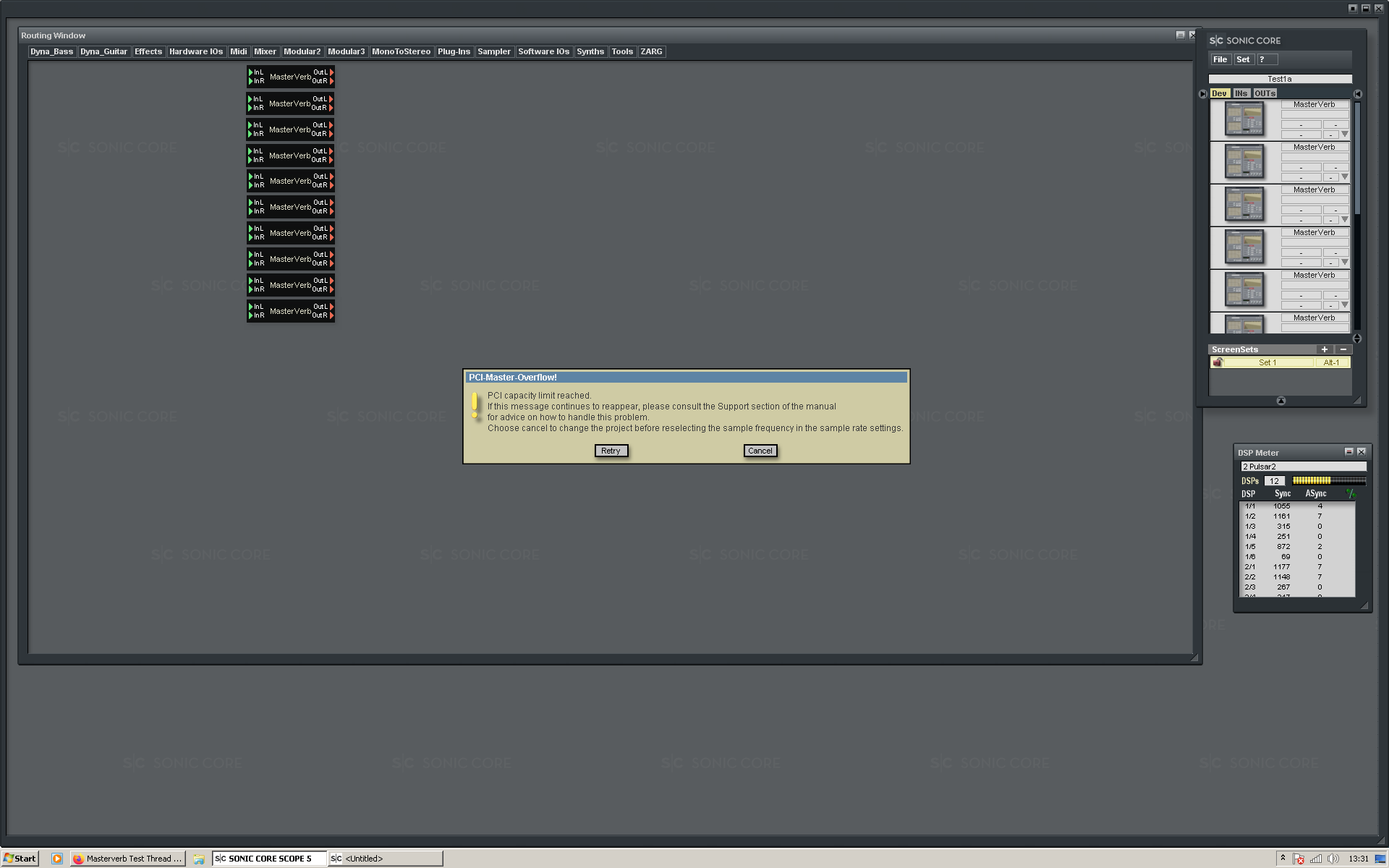

ASUS PRIME B460 PLUS, SCOPE 2+LUNA, 48kHz. Run out of DSP at 12th masterverb but also receive PCI bandwidth message.

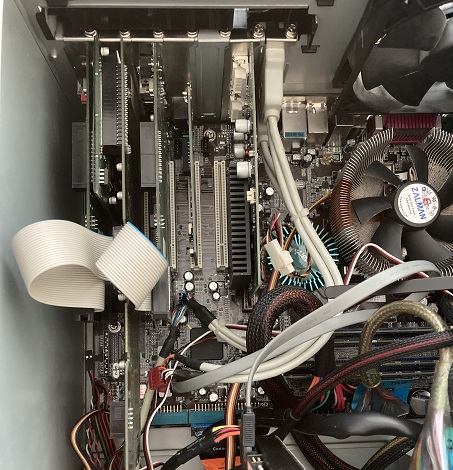

I have an old A-bit IC7 Intel 875-based pentium-4@2.8GHz machine w. 5 PCI slots.
Currently populated with a Pulsar II + 2 x Luna (3 cards, 12 DSPs total).
Machine is running Win XP 32-bit (it's a 32-bit CPU!), no internet. Scope 5.1.
I can run 15 Masterverbs before running out of DSP power (trying to add the 16th).
No hint of PCI probs... Maybe old-school Intel boards work well?
(and just to be sure, this is Masterverb, not Classic or Pro, yes?)
Re: Masterverb Test Thread
Yes, lot's of PCI slots (and seemingly also performance).

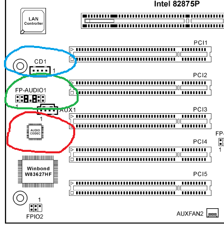

Unfortunately, the PCB designer at A-Bit chose to put the audio chip next to PCI slot 3 (red circle).
And apparently, the audio chip needs Electrolyte Capacitors just next to the chip sticking up from the board.
And a front panel audio connector next to PCI slot 2 (green circle).
And the internal-audio CD connector next to PCI slot 1 (red circle).
This means that "low-riding cards", ie. cards that extendes close to the PCB, like the Pulsar 2, can't sit in those slots!
Pulsar 2 has a bunch of ADAT connectors that means it is a low-rider.
So it physically only fits in slots 4 and 5.
The documentation states that the board with most DSPs should sit in the lowest numbered PCI slot.
(So that the default mixer module goes on that board, IIRC.)
This is unfortunately not possible, as the Pulsar 2 must sit in slot 4 or 5 (4 in the picture above).
Luna in slot 3, Pulsar in slot 4, Luna in slot 5.
So I played around with entries in the cset.ini file, until I got board 1 in the DSP list to be the 6-DSP one.
Whether this solves the problem, I don't know. But it seems to work.
