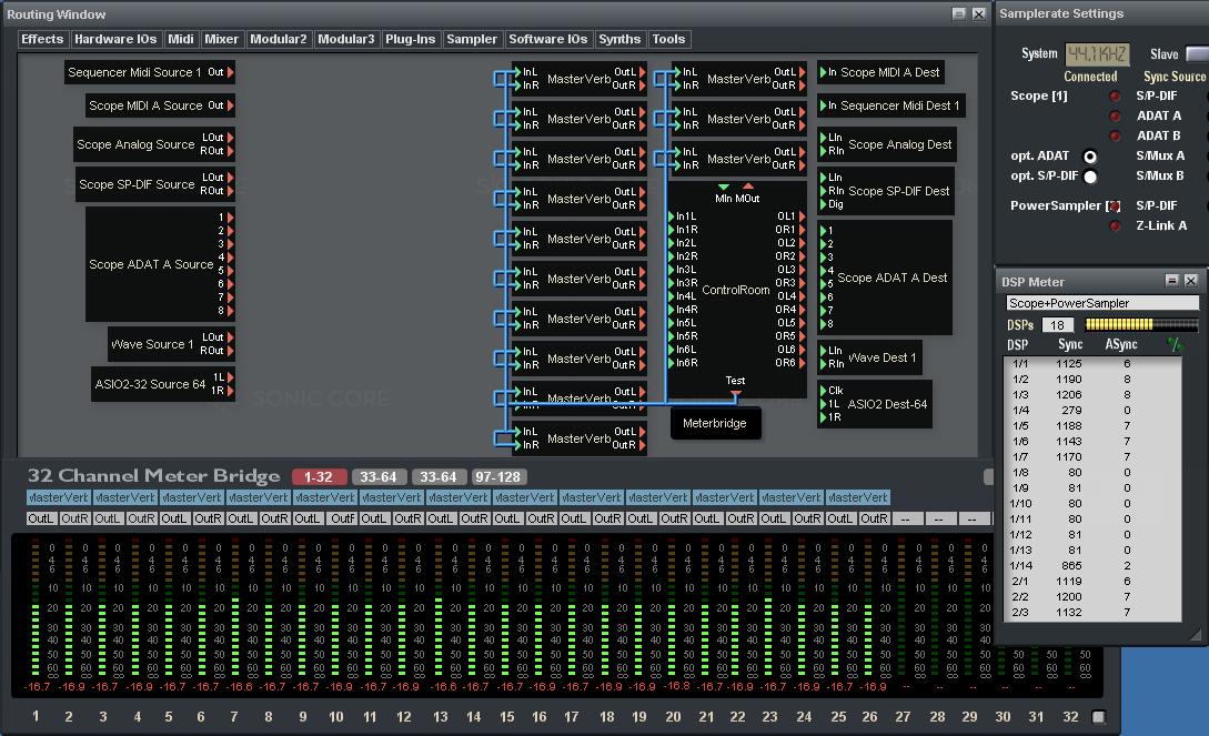

MasterVerb test with aspect of PCI-latency. Pink noise mono input on all MasterVerbs. Wet output levels (dry mute) in meterbridge (running check).
First System:
Board: Gigabyte G41M-Combo (Northbridge: Intel G41 rev. A3, Southbridge: Intel 82801GB (ICH7/R) rev. A1)
CPU: Intel Core 2 Duo E6750 (Conroe, 2.66 GHz, 4 MB L2)
RAM: PC3-10600 Dual Channel (CL-7-7-7-21)
Scope: 1 x Scope (15 DSP), 1 x PowerSampler (3 DSP)
Video Card: ATI HD 5570 (DDR3, 1024 MB)
Result: 13 MasterVerbs (14th brings PCI bandwith error)

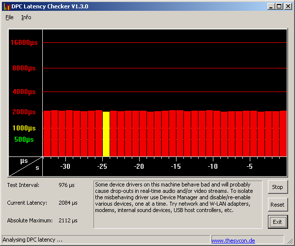

Obviously Scope will increase PCI-latency to extraordinary levels. Are 2112 µs critically?
I suppose coherence between PCI-throughput (of the whole Scope system) and number of used PCI-slots too?

- Scope Routing Window (MasterVerb test running)
- scope.png (96.41 KiB) Viewed 22034 times

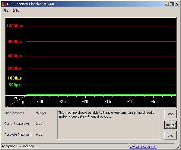

- PCI Latency (Scope not running)
- latency_empty.png (7.53 KiB) Viewed 22036 times
- PCI Latency (Scope running with MasterVerb test)
- latency_full.png (9.16 KiB) Viewed 22036 times
