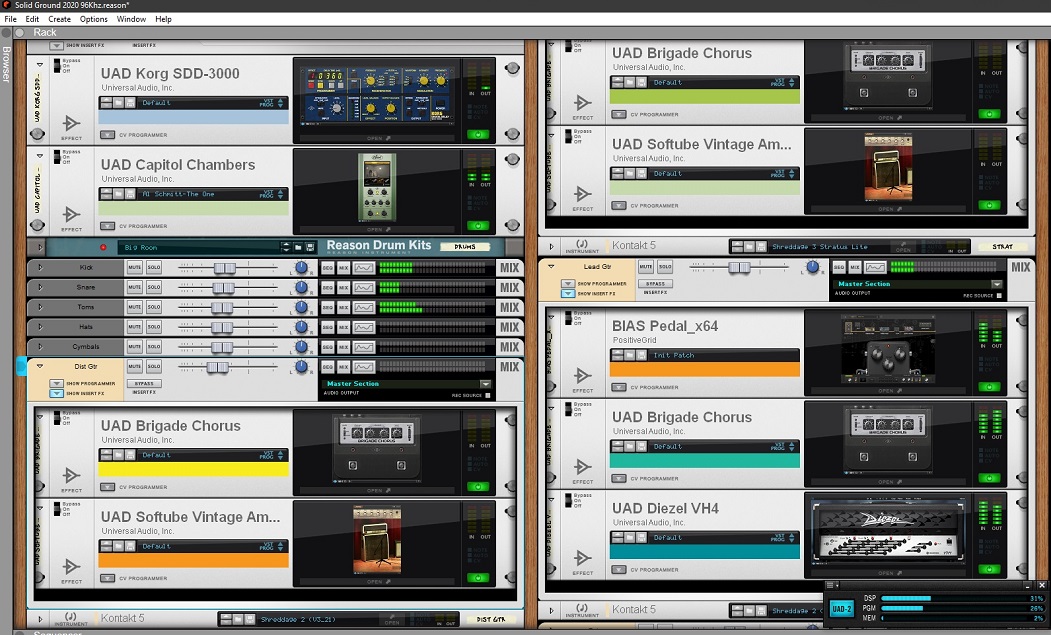

@valis, my typical Reason usage is below, with 3 instances of Shreddage e.g. going off in series to a native VST then 2 instances (each) of DSP plugins. I can play/record these guitars via Scope MIDI in real time jamming along with the track playing back with no noticable latency (@96Khz), native DSP hovering around the 30 - 40% mark and UAD DSP around the same mark.
So I imagine my use case for Scope XTC would be a lot more modest with less round trips etc and no realtime requirement (rendering a Scope synth to audio whilst I sit back and wait).
XTC would be more about workflow for me than breaking system or realtime records - the convenience of having proTone or Ocean Storm set up in the DAW - no need for a separate Scope project with its routing ( & loopback for rendering), since the VST architecture itself would take care of the routing (as it does when I drag and drop a Brigade Chorus between BIAS Pedal and Diezel Amp).
