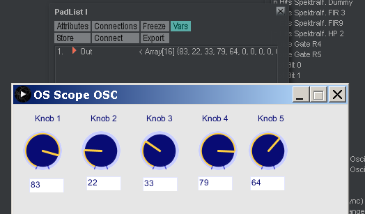

DragonSF wrote: Tue Dec 19, 2017 11:14 pm Scope arrays are a mess. Having 16 outputs instead of an array is (IMHO) the preferred way. And arrays are not updated automatically. You need to reload/reconnect the module to get an update.
We used array (inputs) a lot with ScopeSync and they work ok-ish. I'd assumed the main issue I had with output arrays was around memory allocation, but interested to hear your experiences.
I'm happy to set the module up with however many parameters, it's just a small piece of work in one place. Arrays would be fantastic if they could be made to work well, but certainly my experiences haven't been amazing either. In the short term, for proving concepts, I'd suggest having a small module and then we can extend later once things are working well.

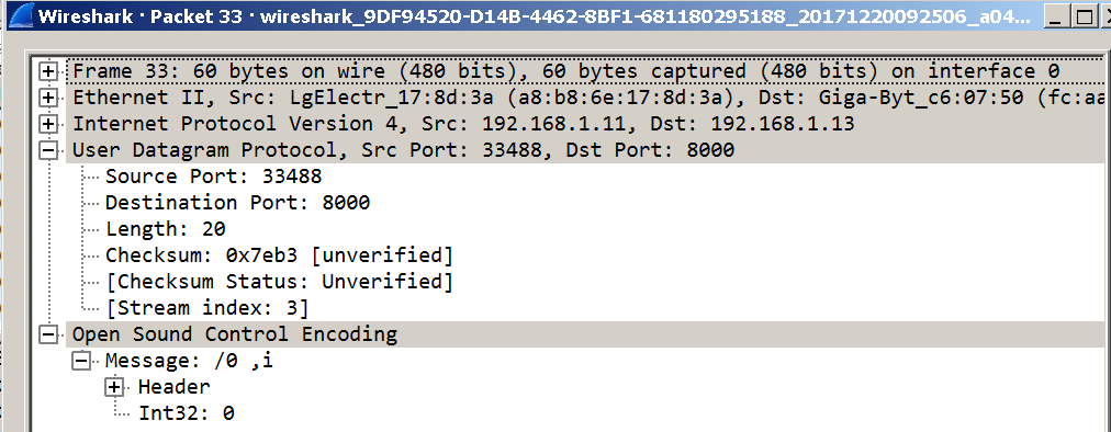

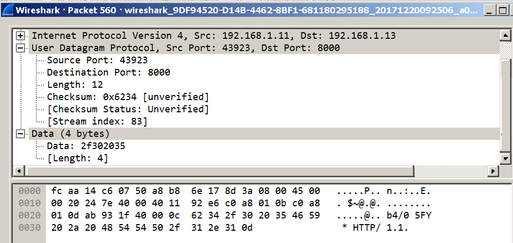

faxinadu wrote: Tue Dec 19, 2017 10:26 pm ok i have done some more testing and it seems the sdk module is not so reliable.
with the app that i confirmed works, and also seeing it transmit every button press over wireshark without problems, the sdk module seems to work only some of the time.
I'll do some more testing tonight, but if you're able to share a screenshot of your SDK project, so I can see what modules you're using that would be really helpful, so I can set up the same test.

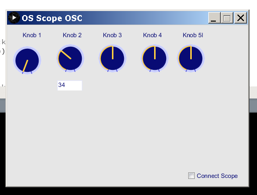

In the meantime, I created a new version of the module, with individual outputs as requested. I also added a listen port input. Please note that there is only one instance of the OSC Server for any loaded OSCReceiver modules, so if you set a different listen port for different instances, only one will work and it'll probably screw things up a bit! We'll probably have to have a think about how this should work ultimately, as it's definitely beneficial not to start up a load of instances of the Receiver, but if different devices use it we could run into problems.
Other important fact is that I changed the addresses to be 1-based, so they match the parameter numbers, so /1 will hit O1.
There's also a little testing app if people want to try (just the example that is included with Juce). It sends messages on port 8000 to /1. You can find it here
