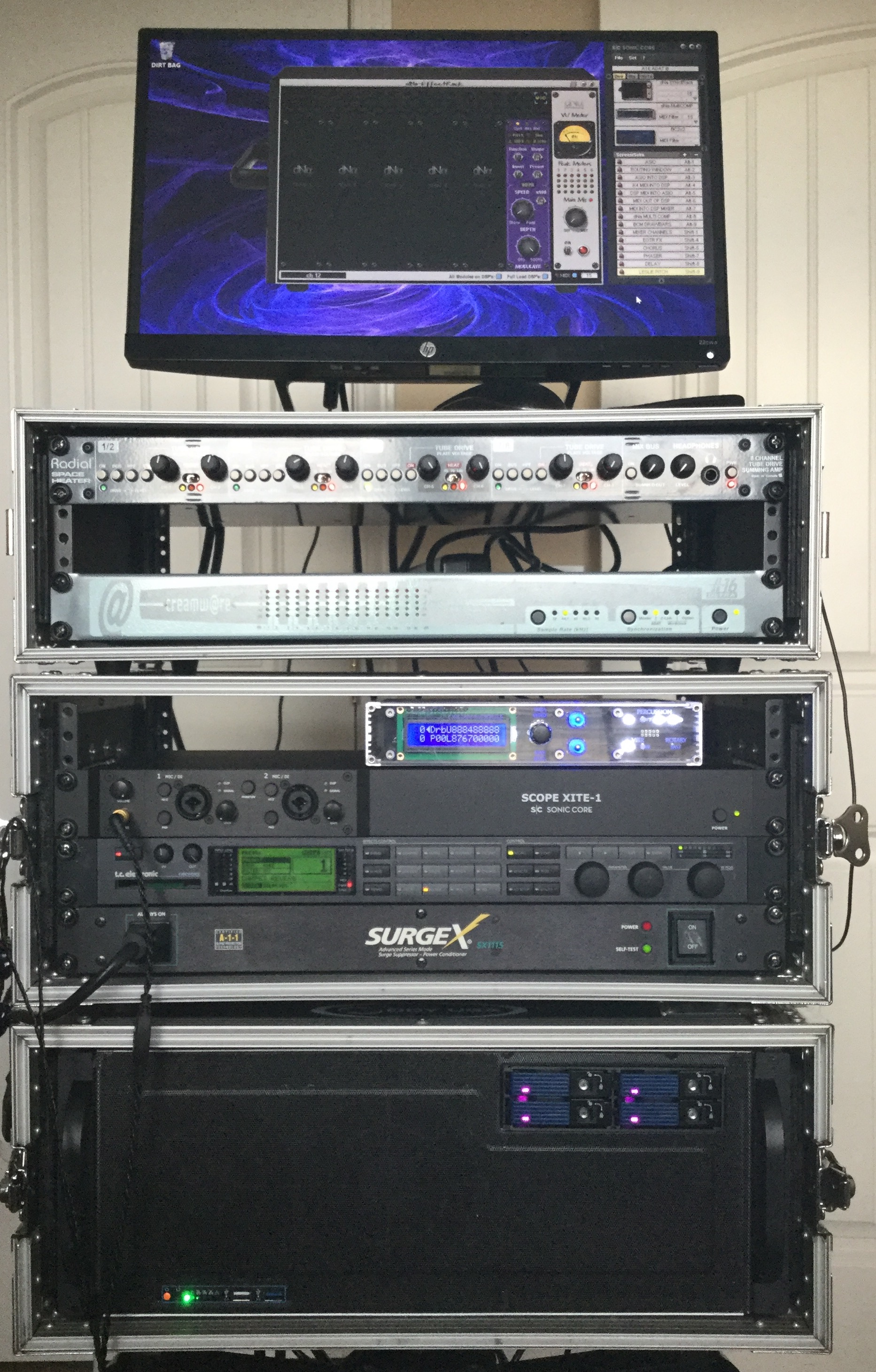

Just bought the racks after playing around with them for an hour. Helps support the platform too. I have to say the clarity of the sense of space it gives is much clearer that what happens the the native PC setup. Ever since Vdat I feel scope gives something when it comes to the overall sound. I've only played around with the reverb but the choruses look good too.
I tried to use it in 96khz but it wouldn't allow me to load the reverb. PCI couldn't handle it. Could someone try it on x-ite and comment on it. Even with Celmo's plugins Scope does something magical.
Thanks DNA keep up the good work.
