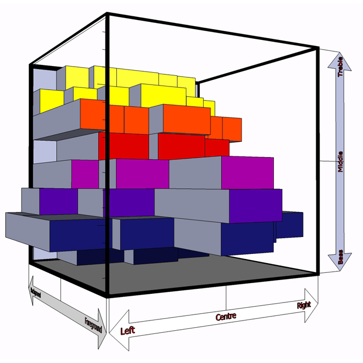

I really like John Paul Braddock's cube visualisation, because its how I've been thinking of mastering recently - that of filling up the audio space which is a cube - vertical = frequency : horizontal = mid/side and depth = volume front to rear. Although my visualisation was only a 2D square until I saw this :
The John Paul Cube
The John Paul Cube
http://www.formationaudio.co.uk/article ... g-the-cube
JPB has a really good 'Modern Mastering' masterclass in Computer Music mag Jan 2015 edition. In particular relevant in this context because it focuses on software.
In the magazine it shows the same cube but filled up - eg solid. I think this might be what you are trying to achieve - so helps to be cognisant of 'loudness' in those 3 dimensions rather than just a single gain dimension.

Re: Need help with loudness maximising chain
I second the 3D thinking in mixing.
Depending on 1. volume, 2. defined frequency respons and 3. reverb amount/type all parts of a song can be placed from front to back in the mix.
Never heard of this cube, good to hear about it, thanks Dante :)
