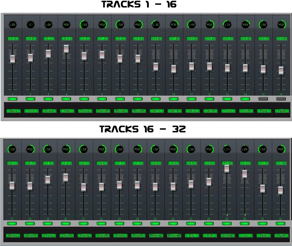

Yogimeister wrote:Dante- its a good idea to try and "force myself" to use mono channels ...
(Im not sure how I feel about the prospects of collapsing stereo tracks to mono though .... I think I would rather narrow the stereo field ... ;)
No collapsing of stereo to mono here : Check the following :
Note the double tracked guitars on 9 and 10 are not hard left / right, neither are vocals on 13 / 14. Synths and the B3 (tracks 27 and 28) is hard panned due to allowing for the rotor effect.
Drums, bass etc are all mono except Toms which is a stereo sub mix and same with room to give wide impression of space.
I used to think having no stereo tracks was a nuisance, but now I like it, its good for placement discipline.
Yes, all the synths (17 - 26) are hard panned stereo, but they are not all happening at once.
