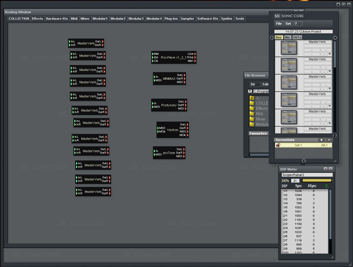

This first generation 15 scope (confirmed right now, from some shots I sent yesterday) worked pretty good with my MB slot 1156, for this reason I had some difficulties to believe that with this new system it was working bad.
I think the overall performance is a mixture of scope and Motherboard together.
So the first generation is not useless with older legacy PCI slots, I guess.
Of course you cannot expect tons of Materverbs, but at least the ability of open several others effects and synths, yes.

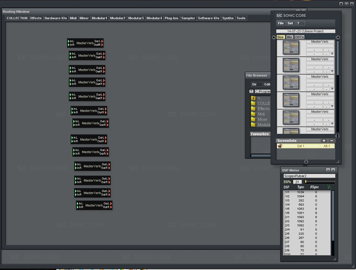

Yeeeeeeah!
Tried Scope 6 DSP (second gen) as main I/O + Scope Pro 15 DSP (first gen) and all works flawless!!!
I can reach 13 Masterverbs before the infamous warning, or 12 Masterverbs nad several synths (until the end of DSP power).
I'm very very happy of this :D
Problem solved, I need just a 6 DSP or 3 DSP board to put as main I/O card.
So: use your first generation always as DSP power addon, not as I/O
