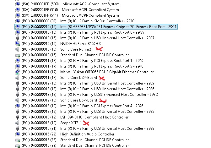

Eanna wrote:Dante, the 64 bit version of the zarg synths use a different device driver for managing stuff probably to do with memory or dma. Can you disable the usb host controller, even temporarily, and retest on 64 bit?
Not conveniently. They are on all 4 of my Scope hardware instances and Ive no idea which one connects my Reason and Cubase dongle, which I need to play QWave :
Dante-IRQ
Dante-IRQ

@Dante, for those devices sharing IRQ with Scope in msinfo32, you can check exactly what hardware items are connected to those ports, by going thru Device Manager's Connections by Type view (see my first post on the matter). Any element sharing IRQ with Scope that doesn't have connected hardware is eligible for disablement. And you may be able to reconnect some items too, move them to different connectors, and then disable those items you've freed up.
One thing I know can certainly cause DPC latency, which may or may not be associated with your problems, is Wifi dongles. If you need it, try to move it off to a separate USB host, or disable that port when using Scope.
Me, I had a 4-port USB hub where I had some other USB bits hanging off. I now have Ableton Push connected to that USB hub, and it's working well. Three USB ports on my PC, two of which had items connected, and some PCIe slots that I don't use, no longer actually function, since I disabled the Host Controllers in the Device Manager.
Like GaryB has always said, I'm now pretty confident that it's IRQ sharing that's the main culprit for Scope misbehaving. My system is now purring like its never done before.

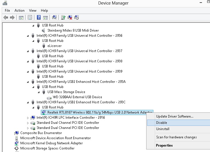

Ive updated a section here under "Reassign IRQs So Scope Gets Its Own" link.
http://www.hitfoundry.com/tsg/tsg_mast.htm
Haven't tried it out yet, will wait until I get myself a decent USB hub. A Rack Mount one WOULD be nice !!!!
But it looks like I can find out the actual devices I know I can disable safely by using device manager (devices by connection) alone by expanding all the nodes within APCI node, without getting the hex numbers from MSINFO32.EXE first - from the below screenshot.
Win 8 Device Manager
device manager.jpg (108.9 KiB) Viewed 3244 times

actually Scope cards are ok with a shared irq involving a system resource like an ide bus or a pci or pcie controller. these devices almost always play nice. firewire, lan ports, usb and to some degree, video cards should be avoided. you can probably get away with a video card or a lan port that wasn't connected while using Scope, but usb must be disable if it's sharing an irq with a Scope card. firewire is best disabled too(when it shares an irq with a Scope card), unless you can use a different slot.

Dante, you really just need to make sure that the USB devices connected to USB host controllers that are share IRQ with Scope are moved to other ports.
Then you can disable those USB host controllers.
I.e. it's only important to disable those USB Host Controllers that are shared with Scope.
And it's better to disable the Host Controller nodes, rather than the Devices connected to the Host Controllers. If you disable the device, you won't be able to use it on different ports. And the IRQ for the Host Controller will still be shared with Scope... Disabling the Host Controllers themselves will mean that the IRQ sharing goes away...
