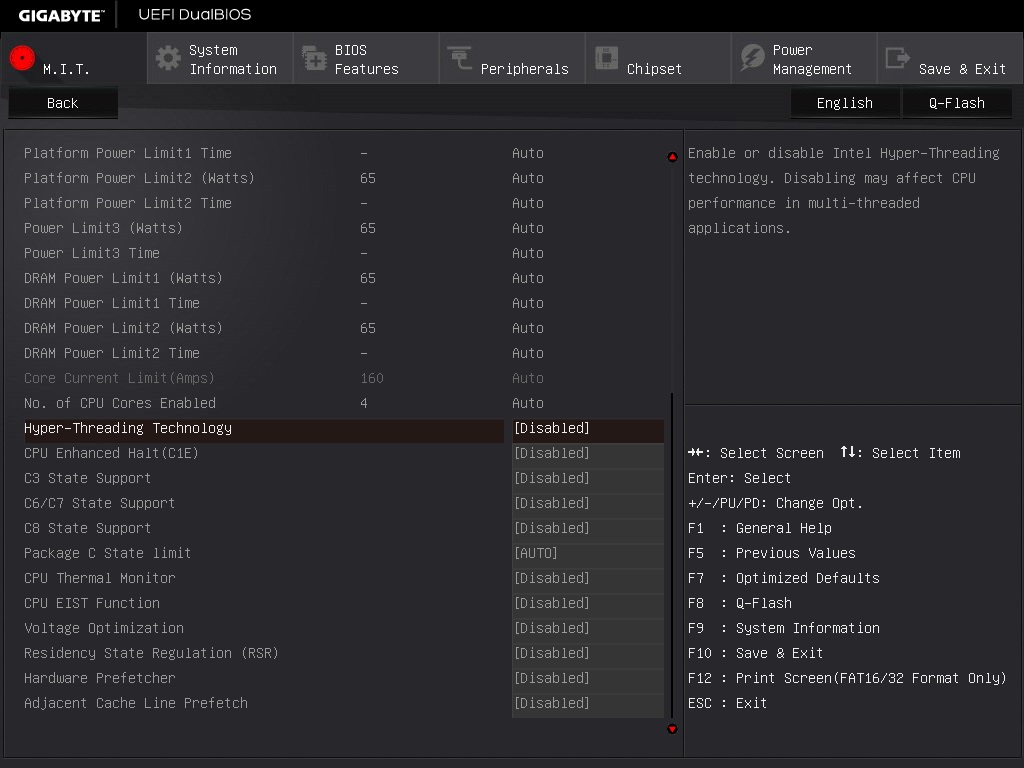

Intel i7 6700 / skylake / Z170 chipset.
I have disabled everything in Bios for CPU configuration.
Advanced CPU Core Settings_[22-11-32].jpg (137.92 KiB) Viewed 55099 times

garyb wrote:some general tips:
as in the letter that came with v5.1, in the bios(you may have already done this) disable any of these things, or anything that is obviously the same, but slightly differently named:
Intel EIST
Intel C State
C1E Support
Overspeed Protection
Hyperthreading
Execute Bit Support
Set Limit CPUID MaxVal to 3 (maybe not so important)
Intel Virtual Tech
Intel VT-d Tech
Hi Gary,
I have looked in the bios settings but your listed settings not found. I have the Asrock G31M-GS. Do you know, or someone else here in the forum, witch settings the best for the board?
Sometimes i got audio dropouts and crackles while playback.
The DAW i got is Sonar X1 on XP sp3. In the PCI slots are one Pulsar1 and a SRB1.
Thanks for some Tips.
Cheers, Tomas
Posts: 23414
Re: setting up your computer
looking in the motherboard's manual, i see that the most important settings are in the advanced cpu settings menu.
hyperthreading and EIST are the most important ones...
exactly what your bios will show depends on what CPU you have, but EIST is ALWAYS there with a newer Intel processor. some 775 processors may not have it, but it's unlikely.
