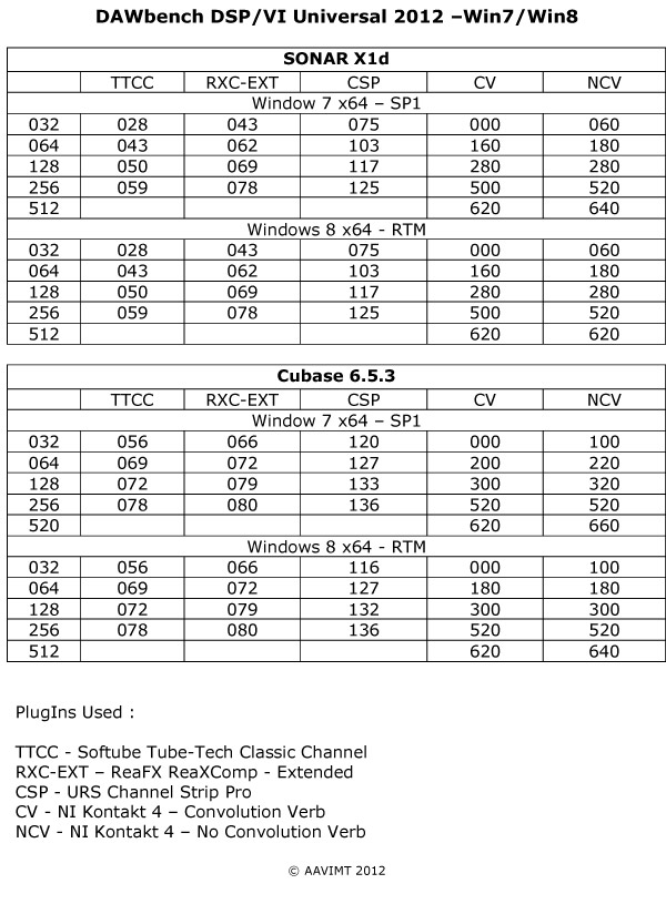

Well it looks like the benchmarks are here from DAWbench.com regarding Sonar and its Window's 8 performance. Basically Sonar performs EXACTLY the same on Window's 8 as it does on Window's 7, there is no difference when using a simple and very scientific benchmarking method. The benchmarks show no difference despite Cakewalk's claims of improved performance on Windows 8. One of the tell-tales was that Cakewalk used a buffer-size of 1024 samples in their real-world project stated Vin from DAWbench.com (TAFKAT), and we all know the horrors of computers/DAWs are revealed in the Lower-Latencies. Below is a copy of the benchmarks wich show Sonar X1's performance in Windows 7 and 8 compared to Cubase Windows 7 and 8 performance (Sonar has never performed as well as some of the other major DAW's despite Cakewalk claiming other-wise). Here is a link to the thread were TAFKAT posted the results on post number 70, also the OP of that thread has worser performance on Windows 8 compared to 7 (may be driver related since every interface company has not updated yet.), here's link and benchmarks - http://www.gearslutz.com/board/music-co ... lts-3.html

Note: The first vertical column of numbers is the buffer-sizes (32/64/128/etc) each column after that represent a different plugin and its instance count at that buffer-size.
I'll probably stay with Windows 7 and skip 8 and won't think about O/S's till 9 or 10 or when i'm forced. I really am glad Sonic Core's main focus is'nt Windows 8 right now cause SCOPE's development is already slow enough relatively-speaking and i don't want them chasing after every new O/S cause Microsoft and Cakewalk says so (to make more money no doubt). I'm a lover of Sonar despite its Audio-Engine flaws and other flaws and will continue loving it for what it has, but i know from past experinces Cakewalk will say anything to sell a product just like Universal Audio and many other companies out here.
