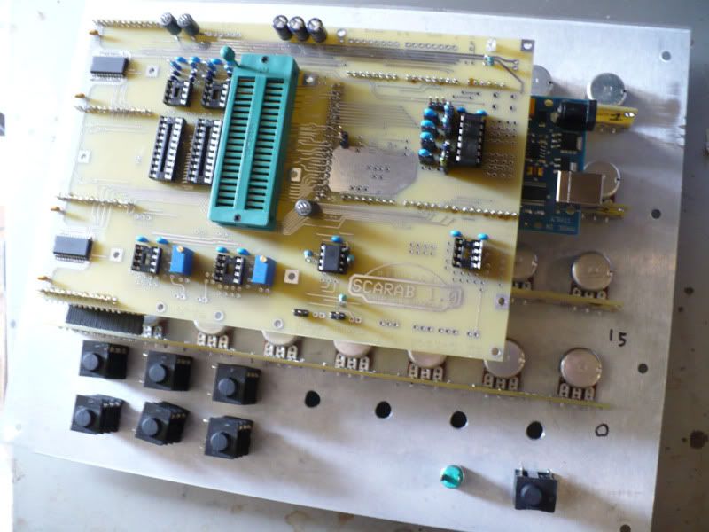

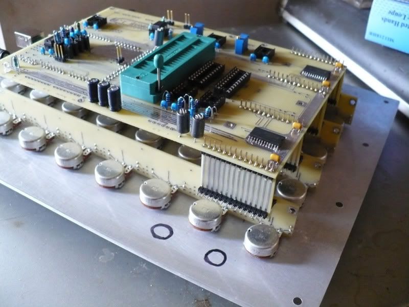

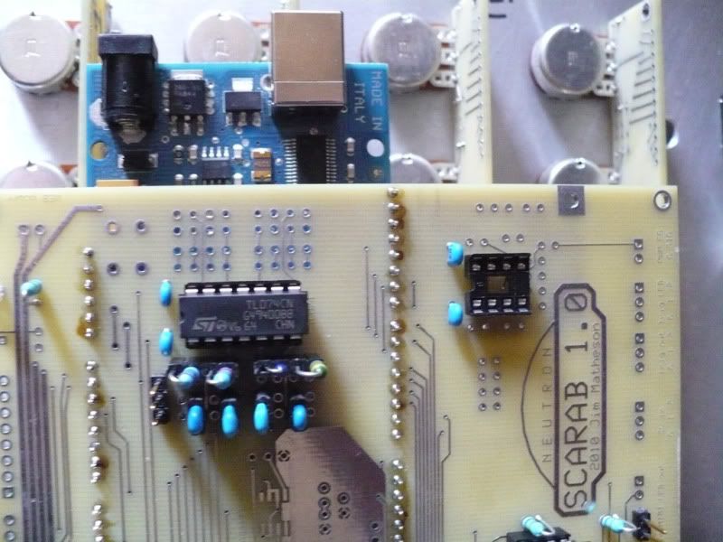

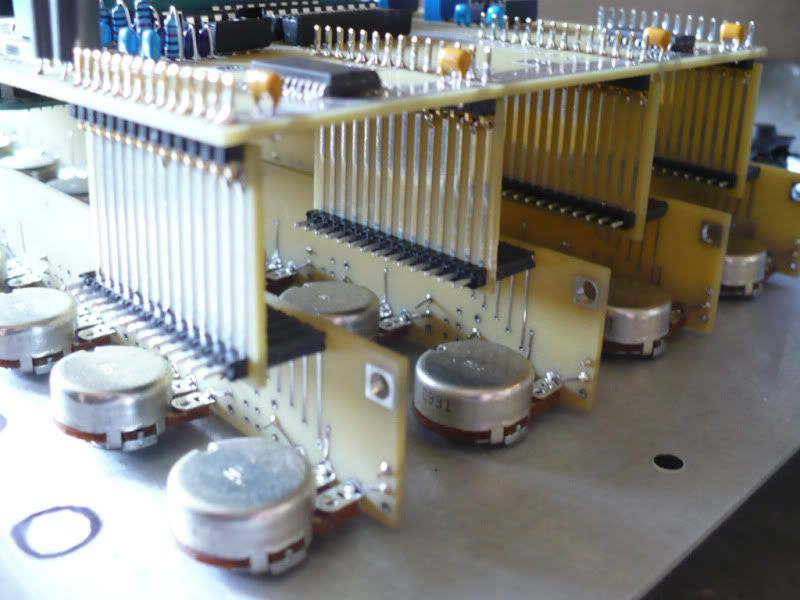

Well its an EEPROM so its programmable from the microcontroller, (actually flash is a kind of EEPROM) i got 128k of wavetables on it, some are ones i made myself, some are from the AVR-X synth and some are from Wiard(sp?) modular wavetable osc.
each of the 32 wavetables has 16 waves carefully kept in phase (for mixing) and it completely scannable so you can start the wave playing anywhere in the 16 wave group (and below and above by a switch) and if there is a glitch between the last and first sample it is fixed with a 4 sample slope so there is no click. this is great for the 2 "main" oscillators having a delayed tracking and getting very rich sounds.
The third oscillator is just used for attacks, exra beef for fade in type dnb sounds or a bit of color on the accent it only has an a/d envelope. (but still use any wavetable and be modulated)
now i am working on tweaking the envelopes and modulation matrix, (huge "long" integers rather than floating point, the little chip can handle that and still loop quickly) its amazing how a proper log decay makes things sound A LOT better.
Untill i get the "LCD backpack" i ordered i can not use encoders/menu system so i have 16 knobs multiplexed, and 16 knobs coming in by MIDI(doepfer pocket control). they have pretty much run out because there is a comprehensive modulation matrix(encoder code is working, just no display to show pages).
For now i can modulate the filter frequency with env1, env2, LFO, and velocity
and the frequency of osc 3 with the same things. whan sync is on changing the frequency of osc3 gives a lot of nice timbres. (it does not sound like analog sysnc, more like paradox)
I started out with a little fun project but it has really grown, and is becoming a proper synth. once it is done it will take proud place in my studio.

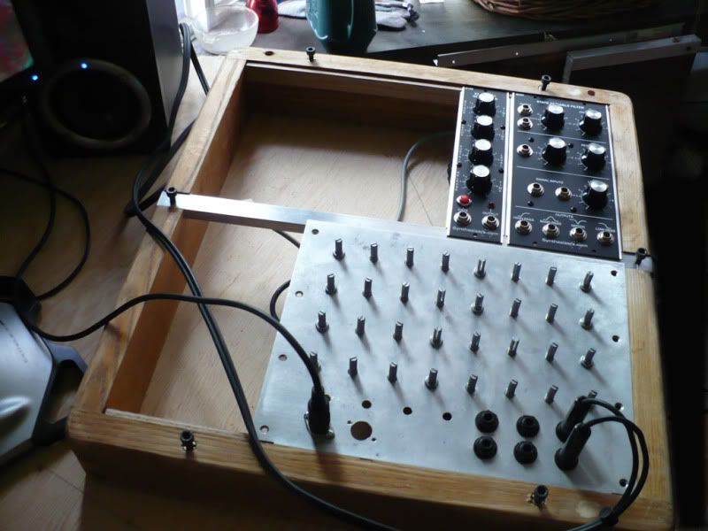

a little update on making a modular version. I got some synthesizers.com modules and some extra blank panels to put my diode ladder filter on, and this will fit as well
Now i am waiting for a part i stupidly forgot to order for the power supply, which i need to test the filter.

Its got some company!
now i can start testing with some basic modules in this little frame
when it is finished it will stand up, and have power supply etc. what i made there was just from stuff i had lying about, and the nice oak frame thing someone threw out.
The new version sounds a lot better, the Proper filter for the envelope signal, and proper 4 quadrant multiplying of the DACs still experimenting with the program as well, trying various things based on velocity etc.
