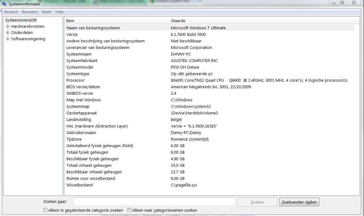

microraver wrote: ???? I'm using here Win7 Ultimate 32bit with 6 GB ram !!
Sorry, but you're not. Go to Start/Control Panel/System.
It will show how much ram is installed. It will also say in parenthesis that only "(3.5 GB usable)" if you have over 3.5GB installed. The OS doesn't use anything over 3.5GB even if it shows more available. It is impossible to address more memory space than this using 32bit architecture.
So, that extra 2GB you have installed is sitting there doing nothing.

Posted: Mon Aug 30, 2010 9:59 am
by microraver
For all the UnBelivers , try msinfo32 and see what you have !!
Here is mine !
