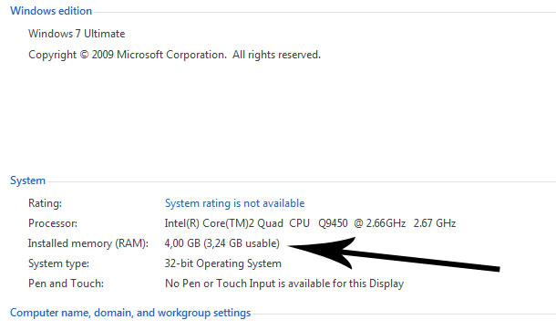

microraver wrote: ???? I'm using here Win7 Ultimate 32bit with 6 GB ram !!
Sorry, but you're not. Go to Start/Control Panel/System.
It will show how much ram is installed. It will also say in parenthesis that only "(3.5 GB usable)" if you have over 3.5GB installed. The OS doesn't use anything over 3.5GB even if it shows more available. It is impossible to address more memory space than this using 32bit architecture.
So, that extra 2GB you have installed is sitting there doing nothing.

microraver wrote:
iSiStOy wrote:Let me just add that it's not because you see 8 GB in your 7's task manager that the OS is able to use it.
This is a question of being able to address such memory ranges, with 32bit.
Ok ,here it is ,see attachement or jpeg !!!
The attachment Win7 32bit 6gb.JPG is no longer available
But iSiStoy is right. You don't see what he talks since you have localized windows version. See this:

For all the UnBelivers , try msinfo32 and see what you have !!
Here is mine !

I have several SQL servers here that I monitor every day, that are all PAE enabled. But only those that we've configured with the AWE and /3GB switches makes one SQL instance use more than 2048MB (about 1734MB in reallife)!
And those SQL instances can under a 32bit OS (namely Windows Server 2003 R2) can max use 3072MB per instance!
WOW64 machines behaves differently!
Application Memory Pool for a 32bit application under WOW64 is max 4GB, but still only if the application is compiled for AWE compatibility!
AWE itself and 4GT doesn't exist in 64bit Windows OS's (even though several apps, including SQL Server 64bit still has this checkbox, though it has no effect if it's ticked or not!), but applications must nevertheless be AWE compiled to be able to use a 4GB application memory pool even under a 64bit Windows OS running via WOW64!
MD69
Posts: 619
Joined: Mon Nov 07, 2005 4:00 pm
Location: France
Re: SCOPE 5.1
Post by MD69 »
AWE switch is useless for DAW app.
To be useful, it would require the HOST appli (Cubase, ...) to use the AWE library ... which is not and will not be the case because it would require them to manage the heap (the memory dynamically allocated is not released after use). Moreover, the VST instrument using the "in process appartment" model, it would require the host to manage the memory for them (there should be an API to the VST instrument in the VST library).
cheers
