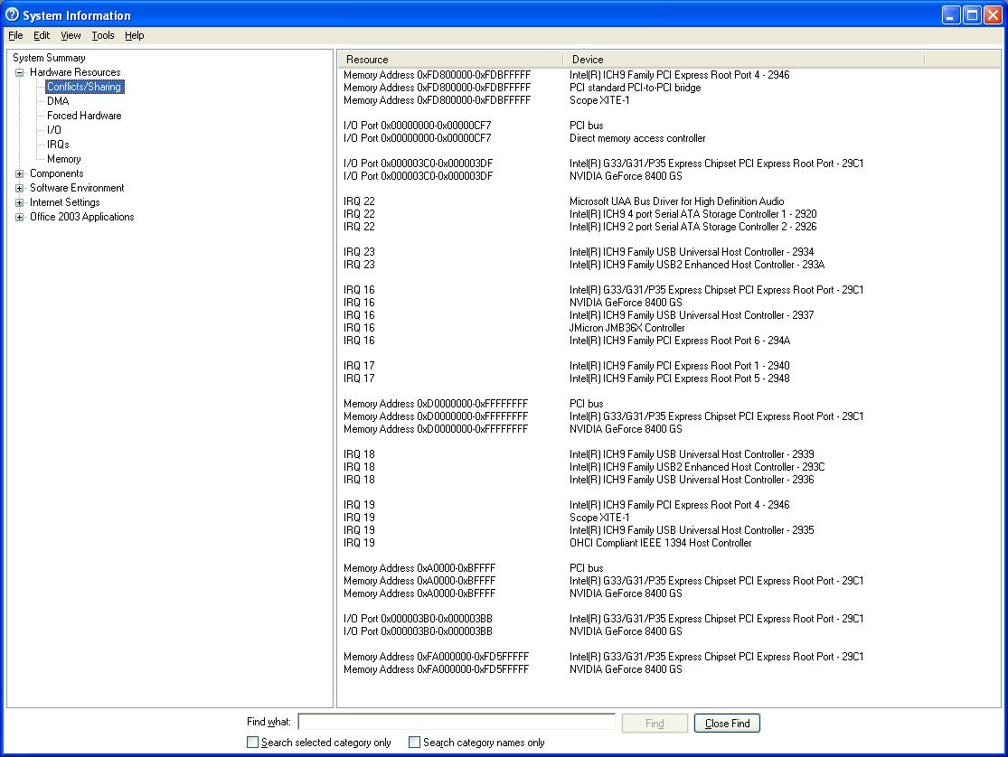

I can only get 13 masterverbs on my XITE1D - exactly the same as what I got on my 3 x cards (12DSP). Mobo is ASUS p5KE Intel quad core 4 gig ram. I have my PCI cards still installed but disabled in device manager. Any ideas about how I can get more PCI(e) bandwidth (or indeed find out if theres a common bottleneck on both PCI and PCIe throughput) ?
Seems to me whatever resource was restricting system to 13 masterverbs on PCI cards could be the same as whats restricting it to 13 on XITE1D (?)
sysinfo
sysinfo

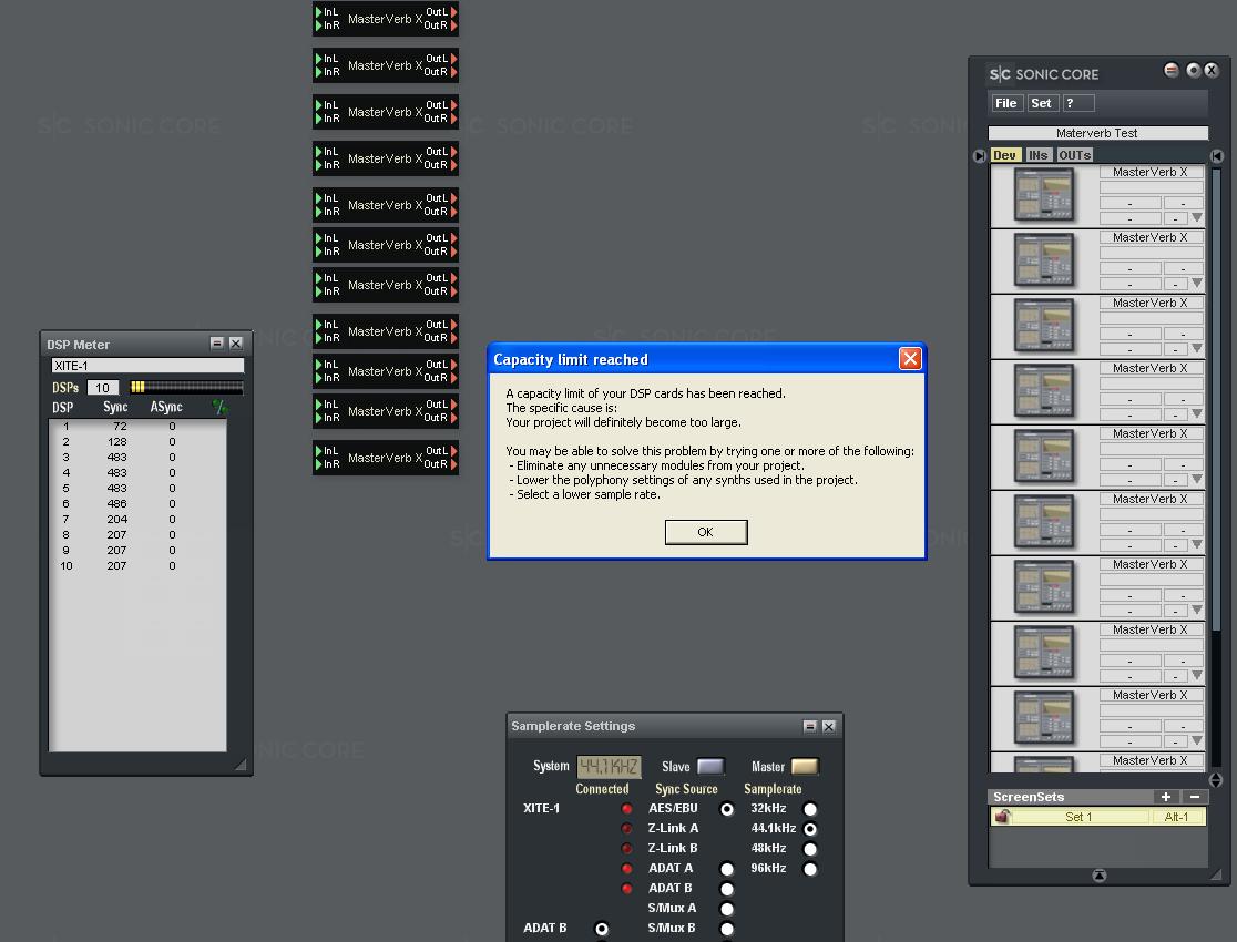

what exactly does the error message say when you reach the 13th(screenshot)?
13 masterverbs is plenty of bandwidth for most situations....
Re: Masterverb Test Thread
Just DSP overload. Makes no diff if I manually assign. Today its maxing on only 11 for some reason.
you don't have dsp overload.
read the mesdsage. you are out of dsp resources for the reverbs. this seems to be pretty much the case for the XITE-Ds. it's possible that in the future, there might be optimization for the Ds that allows better use of resources, but it has nothing to do with motherboard resources, afaik. my guess is that it has something to do with the old and new dsps. if you load the masterverbs and assign them to other dsps, you may find that you can load more....
