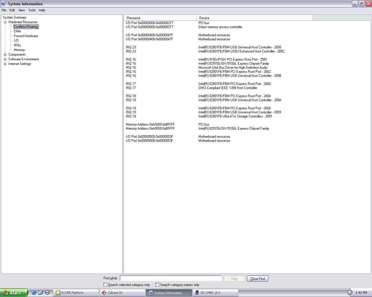

heres another screenshot of sharing,irqs. pci express slot is occuied by the 8800gt graphcs card, which i also tryed removed and got the same pci bandwith results.also checked about the motherboard and its a oem sony motherboard specifically designed for sony; not on intels website and no manual anywhere to be found.

everything looks good.
how about the video card...did you disable accelleration?

i just did a reformat , and tryed disableing unnessary drivers everything i tried gave exact same results
, i guess my board just isnt very friendly with scope, it really is effecting me for i usually cant even load 1 p100 reverb and no where near enough asio sourses for mixing. im think im just gonna go for a new system,thinking pentium quad core, since i use tons of vsts in my projects and i want as much cpu power as i can get. from the forum looks to me that the nforce motherboards get best pci performance and for intel its next to nothings asus motherboard what u guys think?
