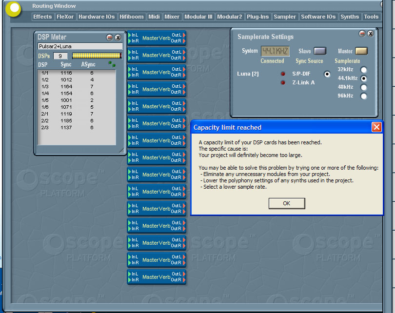

Re: Masterverb Test Thread
Setup:
Asus P5NE-SLI Chipset: nForce 650i SLI SPP
2GB PC6400 RAM
Intel E6600
OS: XP SP3
1xLuna II
1xPulsar XTC
total 9 DSP
Result:
15 Masterverbs, then DSP limit.
2GB PC6400 RAM
Intel E6600
OS: XP SP3
1xLuna II
1xPulsar XTC
total 9 DSP
Result:
- mverb.jpg (178.18 KiB) Viewed 4779 times
Last edited by next to nothing on Tue Feb 17, 2009 2:15 pm, edited 1 time in total.
It looks like you could have loaded more if you had more DSP's ...
I see the synth polyphony window...not the PCI bandwidth thingamajig..?
ooops, typo... ofcourse i ment DSP
I'll correct that!

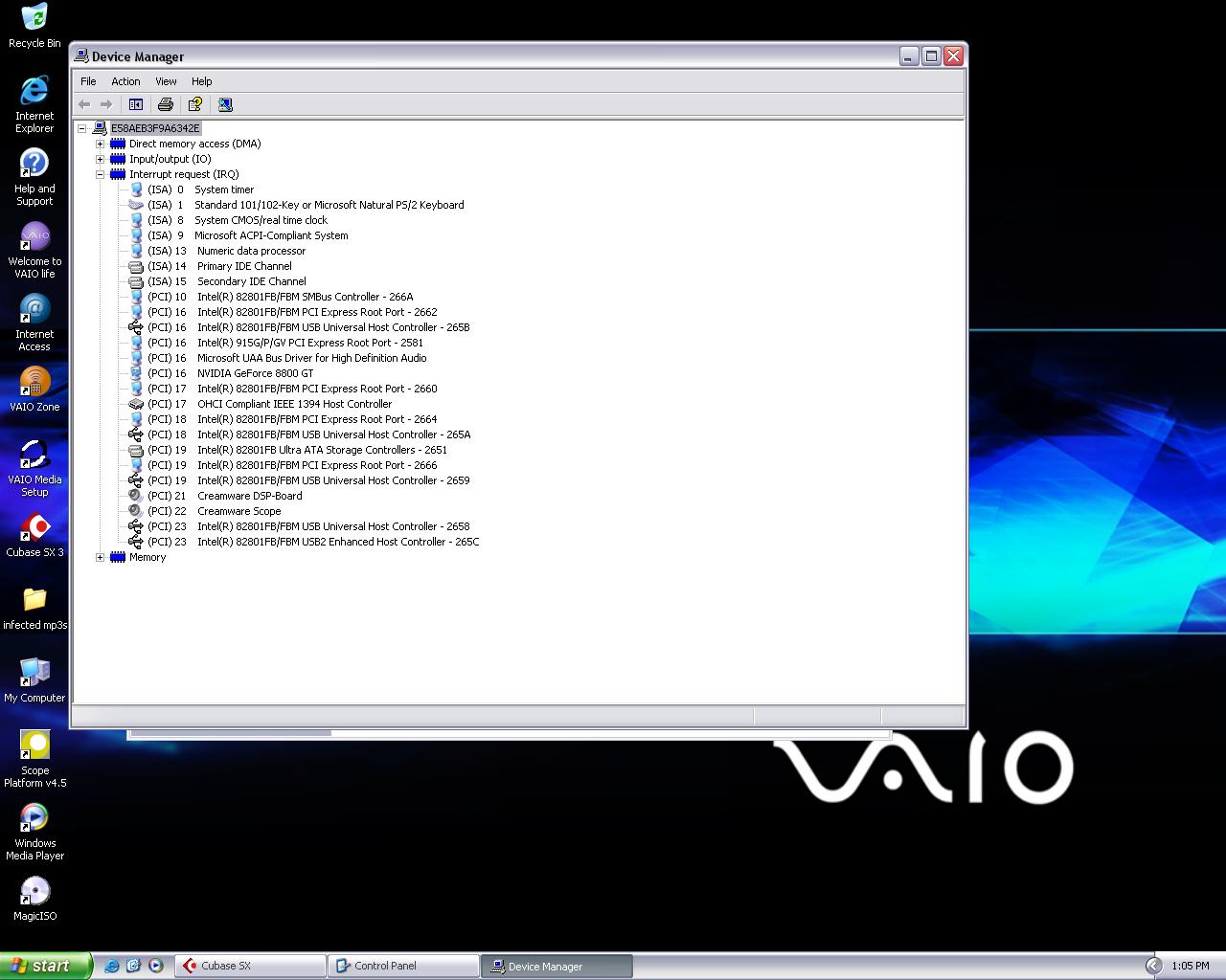

theres only 2 pci slots, both used with the 2 cards. im pretty sure that theres no irq sharing, heres a scrrenshot of my irqs
- untitled.JPG (142.41 KiB) Viewed 6179 times
To see if your IRQs aren't shared, go to start menu -> run, type winmsd, hit enter, see in the hardware tree if there are IRQs shared.
what's in a pci-e slot?
