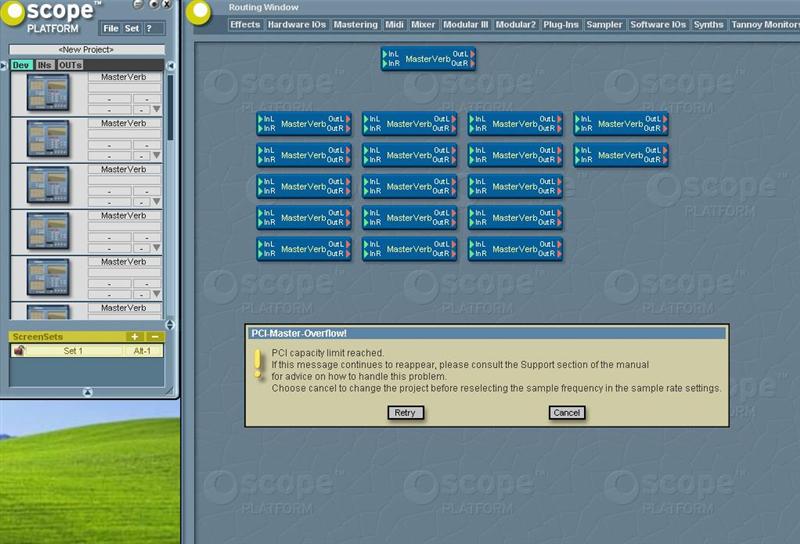

ChampionSound
Posts: 334
Location: Netherlands
Post by ChampionSound »
- Asus P5B533
- Memory 1 GB (brand/type unknown)
- P4 2,0 GHz
- ATI Radeon 9000
-1 STDM cable
- ULLI = 7 ms @ 44.1 kHz
- 2 x Pulsar 2 + Pulsar 2 SRB (18 DSP total)
17 Masterverbs successfully loaded, PCI capacity limit after loading 18th MV (with DSP meter at about 75 %) :)
Masterverb Test Thread.JPG (67.33 KiB) Viewed 6083 times

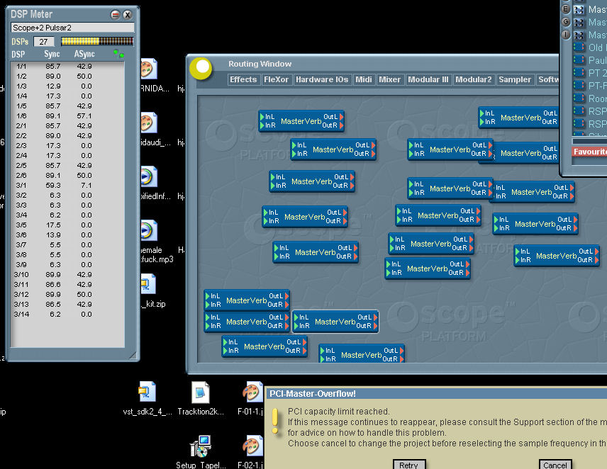

olase
Posts: 23
Joined: Tue Feb 14, 2006 4:00 pm
Post by olase »
Asus P5AD2-E-Deluxe
Pentium 4 3.2GHz
1GB RAM
Geforce 6200 TurboCache
ULLI settings 7ms @ 44.1KHz
2x 15 DSP Scope Boards
PCI Overflow at the 10th MasterVerb! :-(
Either is has to do with my cheap graphic card or the TC Powercore Element on the third PCI slot...

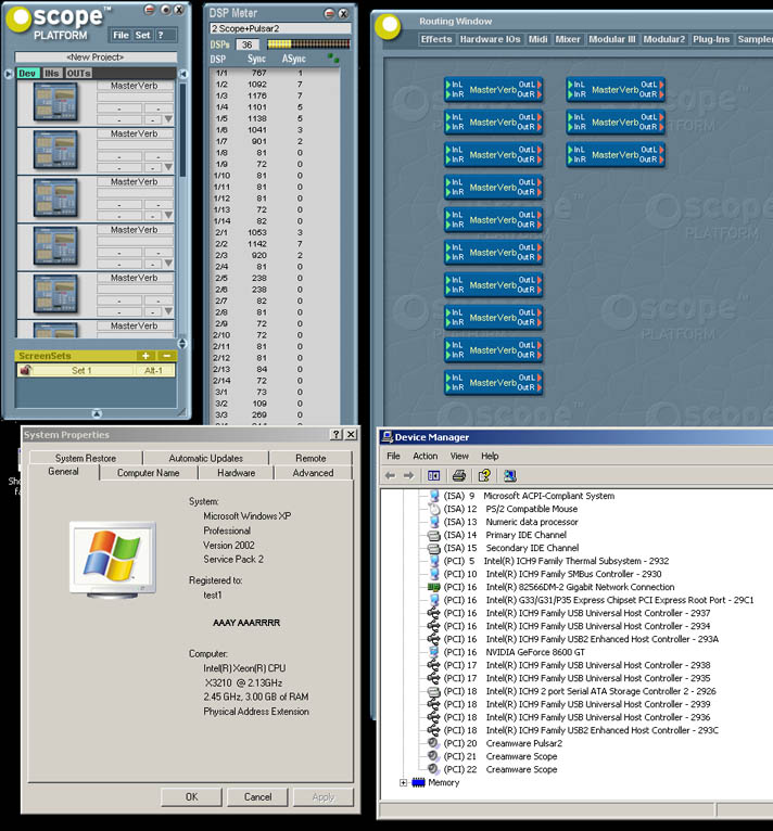

Neutron
Posts: 2274
Post by Neutron »
My supermicro CS2BE had a tragic accident involving a defective ebay USB hub. now it wont boot.
Use powered USB hubs for the first one connected to your PC!
so i got a gigabyte p35-DS3R, which is actually very nice for the price. it seems well made (taiwan not china) has all solid caps blah blah blah. but the colors are a bit hideous. asus does not make any card with 1 graphics and 3 adjacent PCI slots, besides i have kind of gone off asus lately.(i never though i would say that, times change!)
It gives me 3.5GB of 4GB in windows instead of 3GB. i believe because there is not an additional graphics card slot.
BUT on the cs2BE all the Scope and pulsar show up together on IRQ22 but on the D3SR they are all different and mixed in with what look like about a million different USB related things (usb host, usb2 host etc etc)
i just used my previous install because chipset and almost everything was the same, except ICH9R instead of ICH9 and different network chip.
A question probably for GaryB i tried setting the ACHI on the hard drives but windows will not boot. it shows xp logo for a sec than a quick BSOD and reboot
do i need a driver or something to use it? and is it worth it, i paid extra for the board because of NCQ supported by my drives.
I had a project with already 2 masterverb pros, and managed to load up 11 more masterverbs in to it before PCI limit. it seems 1 better than the CS2BE
and i changed from quad core to a dual core cpu. xeon E3110(which is the same as core 2 E8400 but easier to find and cheaper AND it has a cooler name!)
just for fun i tried overclocking and it went to 3.5 ghz without even trying (no voltage tweaks etc) and it runs nice and cool with scythe andy modded to a 14cm fan.
at stock speed it seems plenty fast enough, so i returned it .
