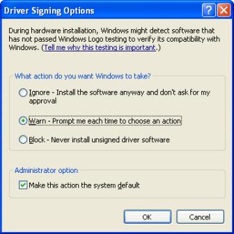

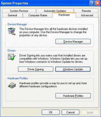

I mentioned it earlier already (see above) ...
set to "ignore" and make it "system default".
Reboot and install the Noah remote Editor software v1.1.
Finally you should have working USB, MIDI, WAVE and ASIO drivers and can use it for playback of media players.
ASIO works too, but because of age it´s not as good as today´s ASIO drivers,- RME or such.
When I used Win XP for Scope, I had to do also for Scope v5.1
I hope that helps and will work for you.
Posts: 7770
Re: NOAH Screen scrambled
You will have to do this for most things now, the certificates in WinXP will have expired for most signing purposes.

Hi Budweiser ,
Noah is set to Windows
I set XP Driver Signing to "Ignore" , set as Default , Rebooted and tried again .
XP finds the Noah . I selected "Install From Removable Media"
I can then see/hear the CDR searching the Noah disc.
But I'm still getting "The wizard cannot find...."
Should I install the Noah software first and get back to this later instead ?.
M

MrV wrote: Sat Feb 03, 2024 7:48 pm Hi Budweiser ,
Hmmm, dunno what that is ...
I didn´t install from disc.
Instead, I downloaded all the latest software files needed after I got keys from S|C.
For installation, I had everything in a folder on desktop and pointed on locations/sub-folders containing requested files to install drivers and software v1.1.
That worked perfect after I had set driver signing to "ignore".
