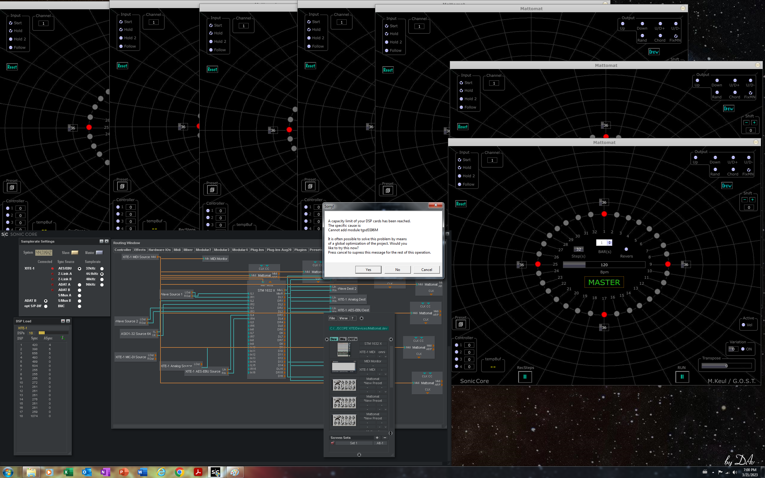

@ Sonic Core: Maybe a longshot, but I hope that V8 can improve what seems to be expresscard bandwidth limitations. E.g. I can get only one stable Mattomat loaded on my laptop, but several Mattomats on my stationary PC.
i don't think it's a bandwidth problem. likely, it is a memory allocation problem(lappy architecture), or a timining issue(lappy architecture again). Mattomat really relies on several system resources, rather than simply raw bandwidth. some laptops may perform better than others...

Quite tempted here to fire up the V8 on my Lenovo P50 with expresscard. Looking forward to hear about any of your observations, once you pull the trigger.
Scope v7 x64 already runs on my (other) Lenovo W540 running Win10Pro.
So, I´d expect it running on a P50 too.
Xite Knight v2.0 wrote: Mon Mar 20, 2023 1:17 pm @ Sonic Core: Maybe a longshot, but I hope that V8 can improve what seems to be expresscard bandwidth limitations.
You say there´s a hardware related bandwidth difference when comparing the expresscard34 and the PCIe x1 card for XITE-1 ?
Xite Knight v2.0 wrote: Mon Mar 20, 2023 1:17 pm E.g. I can get only one stable Mattomat loaded on my laptop, but several Mattomats on my stationary PC.
I don´t use Mattomat, but I can imagine the bandwith limitation you recognize is possibly mainboard related,- laptop vs your desktop PC.
AFAIK, both the currently sold expresscard34 and PCIe card for XITE-1 are PCIe 2.0 standard and x1 (1 PCI lane) bandwidth.
I guess, the older PCIe card (w/ DVI connector) was PCIe 1.1 standard.
I hope this is true ... Holger ???
Yes, Scope 7 runs on my P50.

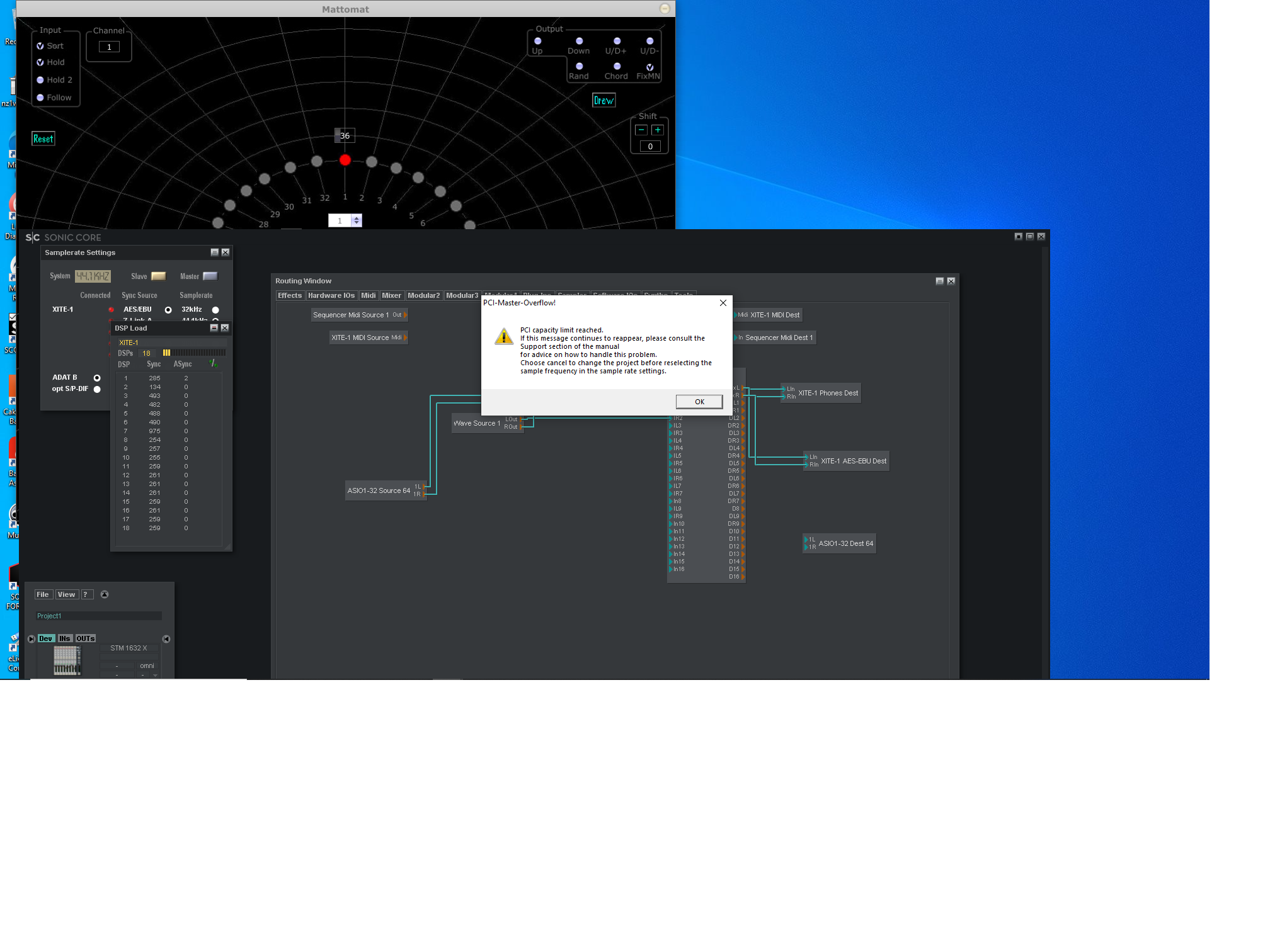

I can load 1 Mattomat and it works fine. But when I try to load 1 more, things start to happen. Some times I get the 'Your device ran into a problem' message + autonatic system restart. But mostly I get the PCI capacity limit message (see screenshot 1)
I just did a quick test, hooking up my Xite-1 to my desktop PC and managed to load 7 Mattomats without any problems. When adding the eighth Mattomat, I get the DSP capacity limit message (see screenshot 2)
That's all I'm saying.
Thanks to the replies from you and Gary, I now understand that the issue is unlikely to be related to my Scope 7 + Expresscard connection, but more likely related to my laptop.
