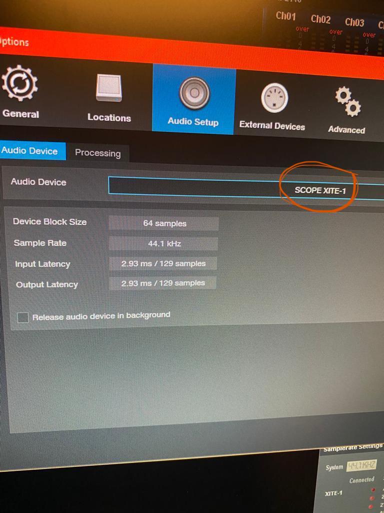

@Katano the time figures on your screenshot are plain calculated values.
For the real world amount you have to track 2 signals to compare (or do a null test with sample delay).
Iirc I‘ve seen many interface specs where measured latency was significantly larger than what you’d expect from buffer values.
(maybe that‘s due to the safety buffer Valis mentioned, but I‘m not that OS savvy)

Yes that sometimes is a cause, some only report the actual ASIO (or core audio) buffer size and not the overall software buffer size, some may also report hardware overhead (chipset buffer size in say ADAT or AD/DA conversion paths). So loopback & tracking tests are the right method, you are correct.

Good stuff, I‘ll do some measurements next time I‘m in the studio
