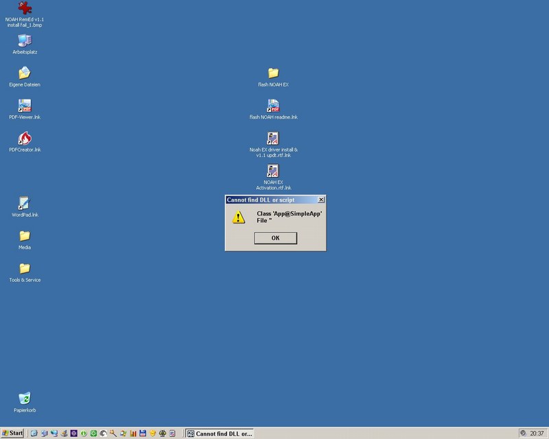

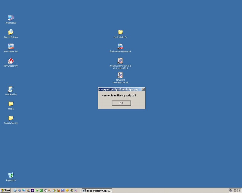

When I double-click the v1.1 setup .exe expecting it will update editor v1.0 to v1.1 I only get 2 messages:
1.)
d:/app/script/App/simpleApp.pep
Cannot load library script .dll
I can only click O.K. and get ...
2.)
Cannot find DLL or Script File
CLASS 'App@SimpleApp' File"
d:/ is the optical drive on the/my computer and Noah EX v1.1 intallation CD is inserted
I dunno what all that means and when I click O.K. again,- which is the only option,- the v1.1 Setup application doesn´t launch.
AND,- regardless of that behaviour,- the v1.0 NoahRemoteEditor software doesn´t synchronize w/ NOAH EX at all,- same what it did before.

Shall I try de-installation of v1.0 editor and install v.1.1 editor all new,- or is there a way finding the files mentioned in messages (see above 1.) & 2.) ) and put ´em into the right places ?
any advice welcome,-

mk_vip
Posts: 39
Joined: Fri Jun 15, 2007 11:09 pm
Re: re-flash NOAH EX
Post by mk_vip »
Bud Weiser wrote: Tue Jul 20, 2021 8:25 am I guess I need a working v1.1 editor and sychronizer/registry functionality to enter activation keys, regardless if it is the complete fileor single keys,- right ?
Yes. The device is activated from the NOAH software. Just need to enter keys one by one (if you have no keyfile).
Bud Weiser wrote: Tue Jul 20, 2021 8:25 am When I shut down the computer, power up again and wait until Windows is loaded completely, then connect NOAH EX via USB cable and power up NOAH,- all w/v1.1 installation CD already inserted,- nothing happens because Noah Synth and USB drivers already exist.
If you have installed the device driver from version 1.0 of the Noah software, then only version 1.0 of the software can be installed.
If you want to install Noah v1.1 software, you should update your installed driver with v1.1 device driver.
And only after that, you can install v1.1 software.

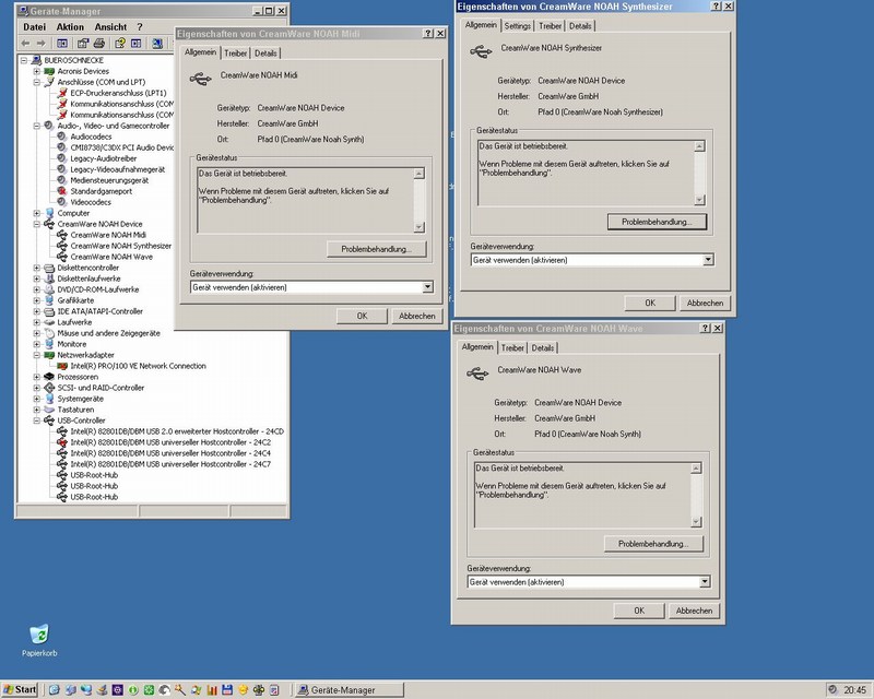

Posts: 2932
mk_vip wrote: Tue Jul 20, 2021 9:03 am Yes. The device is activated from the NOAH software. Just need to enter keys one by one (if you have no keyfile).
Thx,- that´s what I thought too ...
mk_vip wrote: Tue Jul 20, 2021 9:03 am If you have installed the device driver from version 1.0 of the Noah software, then only version 1.0 of the software can be installed.
The existing drivers ARE the v1.1 drivers,- that´s why NOAH Remote Editor software doesn´t work/ communicate w/ NOAH EX anymore now.
What I see in device manager tree is now:
USB icon > CreamWare NOAH Device
> CreamWareNOAH Synthesizer > properties: CreamWare GmbH version 1.2.1.8 Copyright (c) CreamWare GmbH 2003
driver not digitally signed
driver details: cwusb.sys
>Creamware NOAH Midi
driver details, 1st entry: C:\WINDOWS\System32\Drivers\cwusbio.sys
in front of these both the the driver detail entries, there are powder blue colored square icons,- no green "checkbox" hooks like in other entries of the list.
I dunno if that matters, but at least up to now and in NOAH Remote Editor v1.0, the USB online status LED in Live Bar kept dark.
When I go to the main driver property page/screen in device manager,- both the actually installed drivers are reported as loaded and working.
These WERE installed from v1.1 CD because already Flashbox failed flashing NOAH EX w/ v1.0 drivers installed and w/ the message "Warning using older usb driver" (or similar).
I now uninstalled the NOAH v1.0 Remote Editor Software and I´ll see what happens now,- in the hope v1.1 editor will install now ...
Can it be I´ll have to uninstall all drivers and re-install,- then install v1.1 editor ?
Posts: 2932
O.k., I installed drivers all new and now have the right ones working ...
mini-NOAH EX v1.1 drivers work.jpg (105.38 KiB) Viewed 26901 times
...and NOAH EX hardware system version 1.4.23, 2003-10-16 including:
B-2003 / Interpole / Lightwave / Minimax / / ProOne / Sixstring / VectronP / Vocodizer / Eds8i / Prodyssey
but still cannot install NOAH RemoteEditor Software v1.1 because of this behaviour when launching the installer from v1.1 installation disc ...
mini-NOAH RemEd v1.1 install fail_2.jpg (28.98 KiB) Viewed 26901 times
now I´m perplexed because all the other ran smooth more or less and driver installation from same installation disc worked flawlessly ...
Where can I find this "simpleApp" (.pep) script s##t and where on the computer should it be placed/located if not on the CD ???

I´ve found what it is ...
The file "simpleApp.pep" exists in each of the installer packs,- v1.0 and v1.1 downloads from S|C server as also on the original installer CD v1.1 I got from my buddy and made a .iso from.
These 3 files have the same size,- but different date each.
So, WHEN NOAH hardware system is somewhat v1.0.xx xy-xy-2003 and the USBcom settings options are only "Default" / "nonDefault",- v1.0 drivers and editor should be installed 1st.
Then reflash NOAH to higher/latest OS and if that was successful and "system > device > USBcom" setting options now are "Windows" / "Mac-Linux",- uninstall v1.0 and install v1.1 drivers all new to make sure NOAH will comunicate flawlessly via USB w/ the v1.1 editor installer pack,- then install v1.1 NOAH Remote Editor by using ONLY the v1.1 installer pack from S|C server because ONLY THIS has the youngest "simpleApp.pep" file working correctly once NOAH (EX) OS is system version 1.4.23, 2003-10-16.
That´s insane but true,- at least for my NOAH EX ! The original installer CD and .iso both failed even they are v1.1 too.
