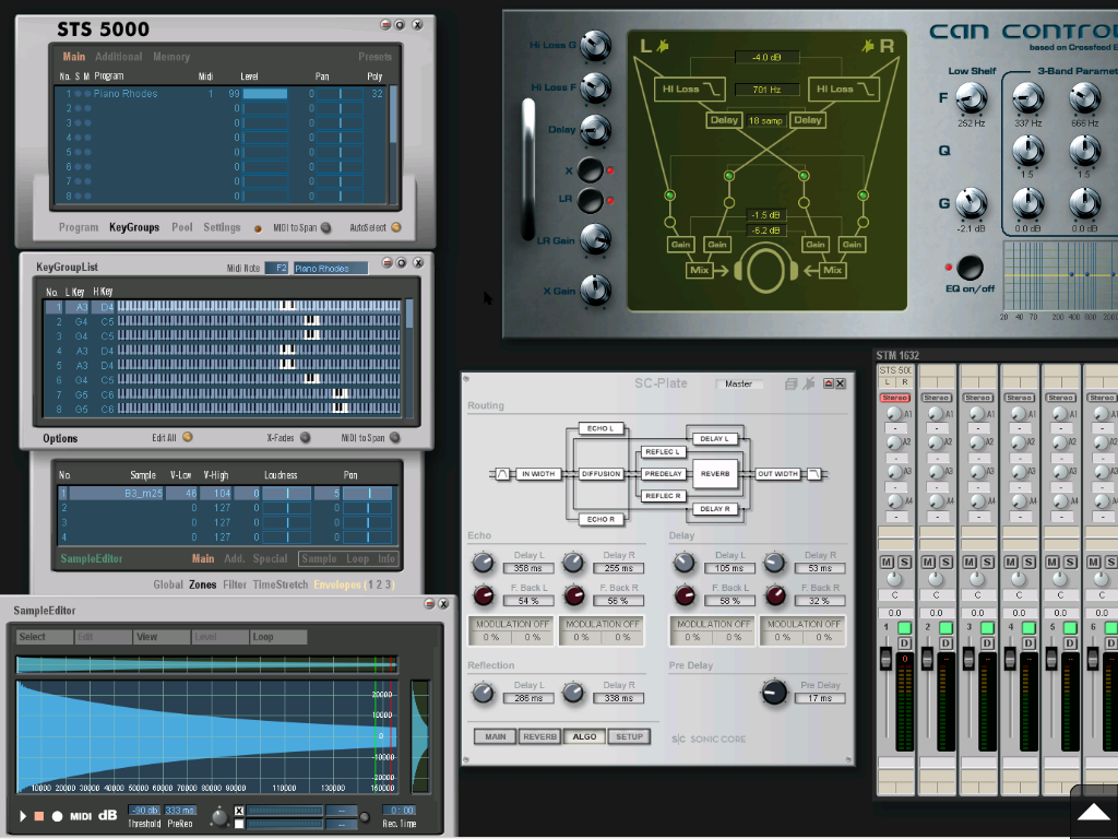

enjoying my sampler here. Its a beast instrument for sure! cheers,

jpo_midigods wrote: Sat Jul 25, 2020 4:19 am enjoying my sampler here. Its a beast instrument for sure! cheers,
Im sorry about misunderstandings, I am using STS on XP 32bits / 2Gb RAM so 512 Mb for samples maximum, for more than 20 years (remember Gigasampler? uh)
Was i was meant is I dont need more RAM since mi heaviest STS pianos has about 512 Mb of samples.
The Rhodes set im (was) using live is surprisingly 9Mb but it has parameters for filters and synth functions of STS that makes it a really powerful and playable instrument.
