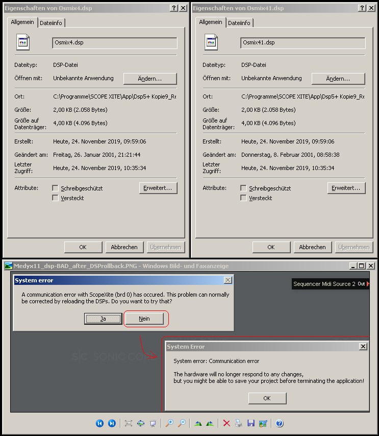

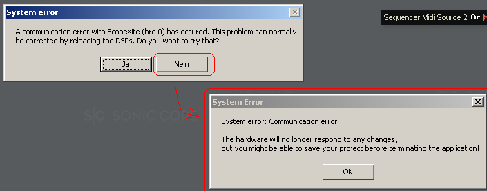

< DSP ReLoading without success
> intel x86, winXP Pro SP3
>> XITE1
>>> scope 5.1
DSP-ERROR after check your Mod Mix devices, without Key, +query cancellation.
Error also after DSP-Folder Rollback :(
on the second same installation on same sytem, there are no problems
but my second installation is not up2date (only for A B comparison+troubleshooting), shit...
i`ve no time+fun to rollback the complete system
please help!
where has Medyx11.dsp entered everywhere?
> scope: ?
> regedit: ?
1000x thx
ron

Hi Ron,
I don't understand the problem.
Modular Mixer v2 needs an activation key, and I changed nothing recently, so it is the same key as before.
It works on my scope PCI here.
I always make a new project , loading the mixer modules first (to know about dsp usage and let scope place the connections where it wants to, and mostly on the same dsp instead of loading them on several dsps because the project is already full of stuff).
If you saved the project and cannot recover your default project, the solution is to rename the faulty devices/folders or move the devices in another location so Scope does not find them when loading the project.
That way, your project can be recovered .
Does it help ?

sorry Mehdi, one must always be guilty :lol:
... i have isolated the problem children. they are temporarily in the BlackList folder...
YOU ARE THE BEST!
\O/
i think, the demo test has probably only triggered a dsp rescan!
:wink: > thanks for that, + jupi, even OSS toys are charging now that complained about it...
i just can not assign the two little devils, maybe one can help?!.
unfortunately, the error messages do not say anything about a source. but for violent escapes they are quite effective :o

I don't know these DSPs, they are not mine. They seem to be in a sub-folder of the main /dsp/ folder ?
not sure what they are for or where they come from...

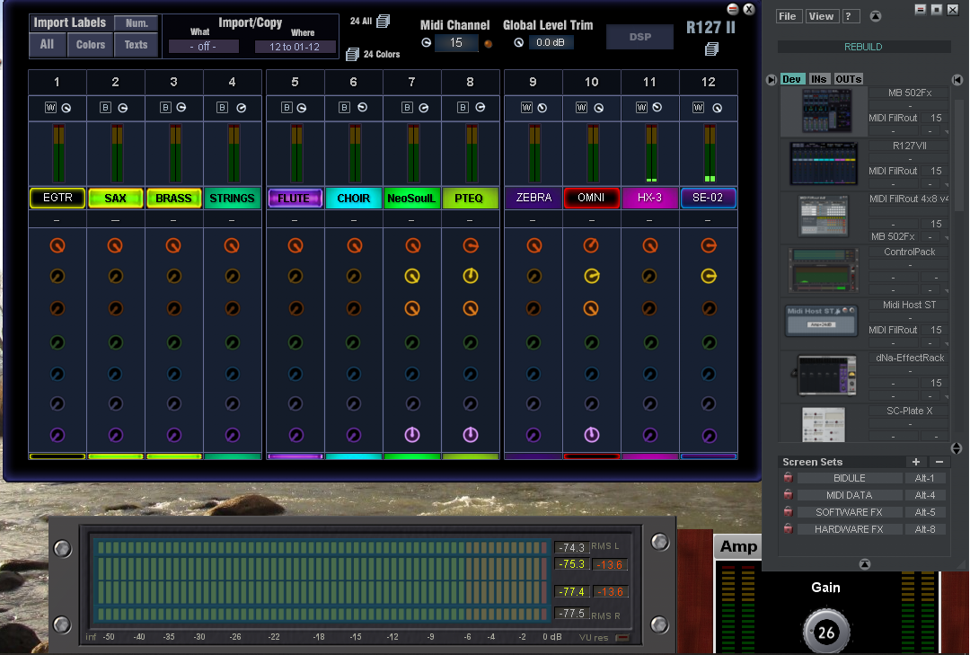

I can now load the Routers and Master Bus versions I need and so I started really checking out the new Channels and routings.
Brilliant the way I can use switches and then change the channel routings using MIDI CC#’s.
My last job is Saturday and I relocate and take a break from performing until I find something I like.
Which means Modular Mixer automations and a whole new set up.
I can’t wait to get these back into a project.

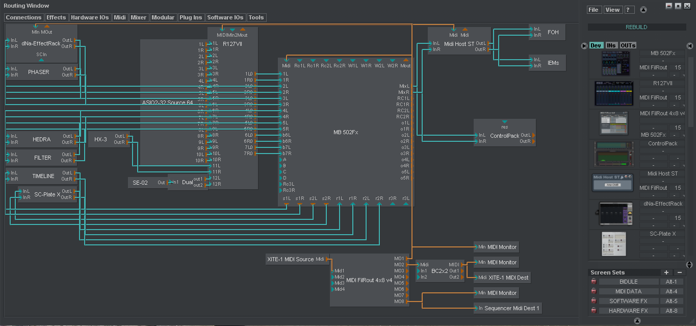

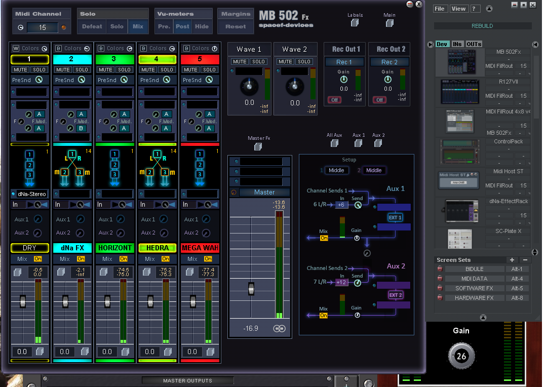

My hardware FX using External Master FX module sometimes need a sample delay adjustment or just have that phasey sound that bums me.
The Master Bus routing options are fantastic for dialing in external hardware.
Even the Warp69 Plate use to bother me but it’s dialed in really well now.
Actually I’m using it from now on since it sounds exactly like a natural ambience.
I have Router Channels 1/2 as my dry no FX channel into the MBus.
Then comes dNa FX Rack, KMA Horizont Phaser, Meris Hedra, GigFX Mega Wah, Strymon Timeline, and Warp69 PlateX.
Fierceness.
Master Bus 502 uses 2 AUX’s but in the project window it shows 3 AUX’s. Ankyu...
