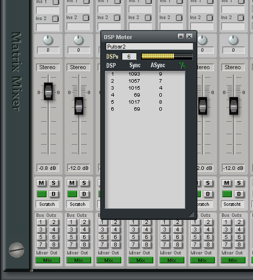

The Channels themselves don't have direct outs, although you could use the Rec Out to send one channel to the outside world.
All 8 busses have direct outs.
The Aux returns are independent of the Busses and return direct to the Stereo mix only.
If you like you could use any 4 of the 8 busses as Aux Sends and use the remaining 4 as Busses/Sub-mixes etc.
Did you find the Aux Send pots under the checkboxes in the Matrix?
Click the green buttons to expose the 16 sends for each of the 8 busses.
Not the nicest way to do it but screen real estate is limited.
I have also updated the mixer again.
This time to add DSP load switching.
With version 5 you can now switch off the DSP loading of all channels, all busses, Aux Returns and Record Out if they are not required - see the little green buttons across the top of the channels and busses, etc.
I have also unbridled the mixer from loading to DSP 8. 9 and 10.
The end result is the Mixer now loads and works XITE and my 6 SHARC Pulsar card, so I think it will now work on most PCIe Cards (probably not on Lunar Cards).
I will leave version 4 up in the first post, but if you want to use version 5 its attached here.
MatrixMixer Pulsar2 DSP.png (38.23 KiB) Viewed 5397 times
