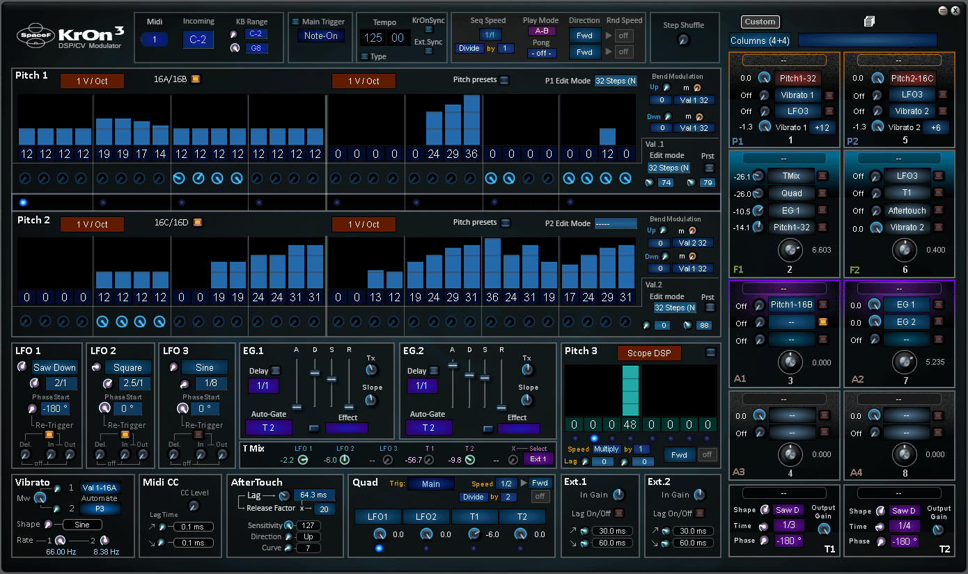

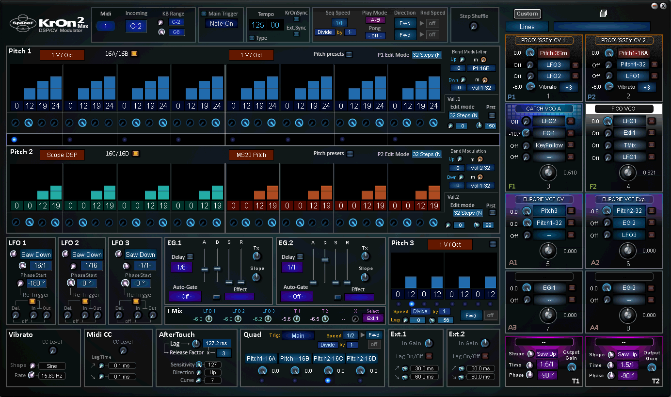

UPDATE TIME (FINAL HOPEFULLY)
KrON:
-- Corrects all overlapping pop-up menus (pitch 1 & 2) that could go behind pots and menus of the bottom sections. Many of those went unoticed by me because of diffrerence between SDK, Scope 5, Scope 7 etc. Now fixed !!
-- Graphics: BPM section graphics corrected (KrOnSync button was hiding texts, no text for external midi clock...)
-- T1 & T2 added as modulators in the P1/P2 mixers but only in the third selector. Because not having them there was totally against KrOn's philosophy (especially when *not* using P1/P2 for quantized Pitch). Now corrected, workflow and momentum are saved (as long as you remember that they are available only in the 3rd selector, which should be fine)..
-- Dual KrOnSync Output: for better project organization, the KrOnSYnc output (Bpm Output Pad) is placed at the top and at the bottom of the device. It is the same pad, just helps to have better looking routing window if possible.
-- KrOn loads with settings that make it easier to hear differences in various "play modes" (check the leds to see what notes it plays in the different modes ==> it won't do anything if you have the same notes repeating on all 4-steps sections, it is much more obvious on complex 32 step sequences: that way you should hear many differences).
--- Litterature: some tooltips were re-written for better understanding (bpm section).
JunZ
-- Added LFO Sync, BPM, internal sync, KrOnSync (no external midi clock = intentional/not important: please use external clock with KrOn or synth like Magma if you really need an external clock).
-- Internal BPM display disappears when KrOn Sync is "On". KronSync button tells you to check tempo on KrOn (it is unfortunately not possible to display the KrOn's tempo on external devices, so you have to check on KrOn if you forget what is your master tempo) (*).
-- Changed color of the audio-input insert slot to grey for better visibility
-- Audio Input send to Ring is now taken Pre-Insert. This allows to have the audio as Ring modulator while audio-in level is at 0.
-- Drone mode button display should be corrected but presets might have to be resaved for correction to happen.
-- More informative tooltips (audio-in ring led-button, kronsync section).
Magma
--- KrOnSync Inputs at the top and bottom of the device for better looking routing window (gives choices).
--- Internal BPM display disappears when KrOn Sync is "On". KronSync button tells you to check tempo on KrOn (*).
--- KrOnSYnc input renamed to "Bpm" for consistency over several devices.
--- NOTE: modulation wheel fader looks like it behave strangely when selected with the mouse but it is because it is actually a rotary knob. It is made to be used with mod-Wheel though, so mouse behaviour has not been changed (the rotary behaviour is the one with the highest resolution or easiest to use in my opinion).
Spirit
--- Drone mode button now in presets as should be.
Many thanks to beta testers who helped a lot in making this update quickly available and as complete as possible...
(*) having the tempo display disapear and leave an empty space can be confusing at first, but adding a graphic that looks nicer implies adding logical modules, controller pads, and graphic groups = additional dsp resources. In the current design, the dsp resources used = 0 ) .
Pictures below:
- it is possible to connect both outputs to different bpm inputs of different devices.
- it is not possible to connect 2 Bpm inputs at the same time. The device will not let you connect the second pad once one of them is connected ("cannot route / incompatible pads" error message = perfectly normal/logical behaviour)
Please NOTE; it is normal that KrOn displays a "division by zero " message when you "Kron-Sync it" with no master Kron BPM plugged into the Bpm inputs. when nothing is plugged in, KrOn sees BPM=0 and cannot compute the actual tempo (0 in = 0 out = impossible tempo).

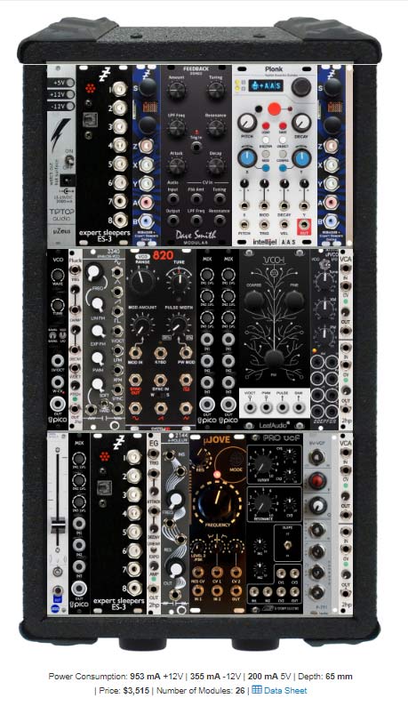

Why not build your own synth with eurorack modules?
I will soon post my DIY method to make a eurorack case for less than 100 euros with 1000 mA power, 84 HP or more.
Eurorack is the way I would advise to go because of the variety of sounds. Even for you dawman :-) You can make a moogy part, mix it with a roland VCO/VCF, add some MS20 or Oberheim filters models or clones... and you don't need to build it at once. begin with a couple of osc and filters, expand as your needs evolve.
The shape of the eurorack case can be the one you want, that is not necessarily the one found in stores, and you can rack it too.
And it does not have to be expensive because there is a lot of new companies/modules that do great stuff for very reasonable prices. You can find expensive stuff too, but they are not necessarily the best (nor the worst, it really depends on who made the module, and there is no rules... well it's true that the moog clones tend to be more expensive when it is not behringer, but this is less and less true).
And a eurorack used with KrOn is simply oscillators and filters, may be some mixer to mix osc and direct them to this or that filter, may be a vca if you want. And nothing forbids to add midi-to-cv, samplers, sequencers etc.

- New presets for KrOn 2 / Max / Mini : they are not numerous but will serve as "'init" or starters. In the big KrOns presets, you will find a 64 steps example.
- Big KrOns: graphics: a display and a poti were appearing above a drop down menu. Fixed
- Mini KrOns: the T Mix inputs were mixed up making it confusing: fixed
- Midi to CV device: changed the name so it looks smaller in your project, fixed the midi channel which was always "omni". (the Midi to CV is used after KrOn to be able to transpose midi notes when using a midi keyboard/sequencer. You don't need to use this device if you use a CV-able keyboard directly connected to your rack, where KrOn does only pitch modulation without sending root note info. The midi to CV device is used to mix Pitch Mod from krOn with the midi root note from your sequencer or midi keyboard).

KrOn 3 is available for download in the user area.

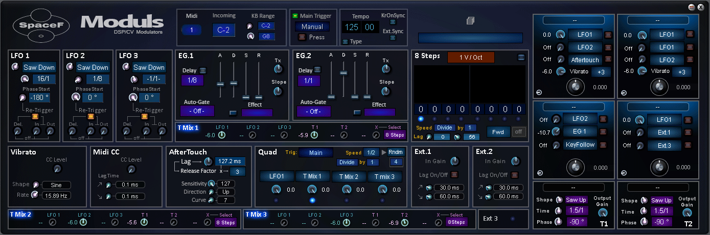

---> Added Devices : Moduls and Pitch 64
---> KrOn 2 still available in the zip files (folder "Legacy").
Please download from your user account. As usual, let me know if there is any issue dowwnloading the update (the zip name has been changed to reflect the date of the file).
---> BIg change in philosophy; the presets recall everything including the type of signal ( DSP or V/Oct or Hz/V).
From now on, the main device is KrOn 3 , with DSP and V/Oct only (as Korg themselves abandonned Hz/V). Hz/V is still available in KrOn 3 "max" and MIni KrOn.

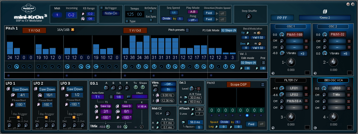

Mini KrOn 3 is also available as a BB3 device (requires a BB3 activation key) @ 29 € instead of 49 € until end of october.
With an xite @44.1hz , you load 2 KrOn 3 + 1 Mini KrOn + Moduls+ Pitch 64 = 8+8+4+4+4= 28 modulator outputs + 6 T1/T2 (T1/T2 are LFOs with their own output...which I did not remove because having those extra outputs prooved useful in several projects).
- Moduls and Pitch 64 should allow to "re-create" a KrOn in 96 khz setup (let me know if not, I can remove a few stuff in Pitch 64 to make it lighter). Pitch 64 is also nice for trigger & gates.
