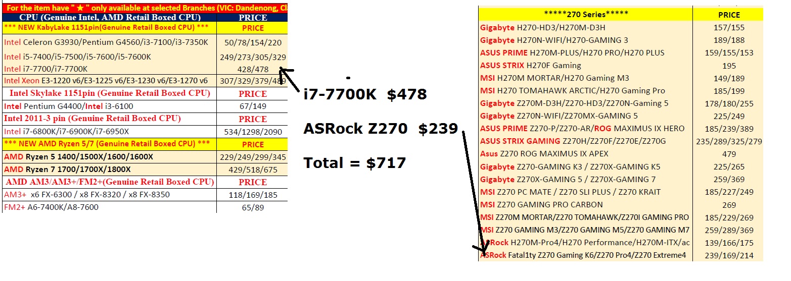

Awesome info. Heres the current AU$ prices for the 7700 - Z270 combo - theres a couple of Ryzen prices there as well for the Ryzen 7 topping out $675
MSY PriceList Extract

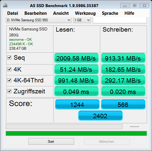

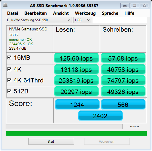

Z97 NVMe scores are 5-10% faster on the Z97s still.
My guess is there's no stop at the PCH, they are direct to CPU.
Dont know why Intel changed the designs that ASRock took advantage of.
These are scores after an outdoor gig using these new Silverstone Thermal Pads that keep the M.2/NVMe drives from throttling from heat.
Even if they throttle theyre still faster than SSDs, but with the pads after hours of use outside in heat they are fast as greased lightning.
as-ssd-bench NVMe Samsung SSD 6.24.2017 1-41-46 PM.png (32.88 KiB) Viewed 5130 times
as-ssd-bench NVMe Samsung SSD 6.24.2017 1-41-33 PM.png (33.16 KiB) Viewed 5130 times
