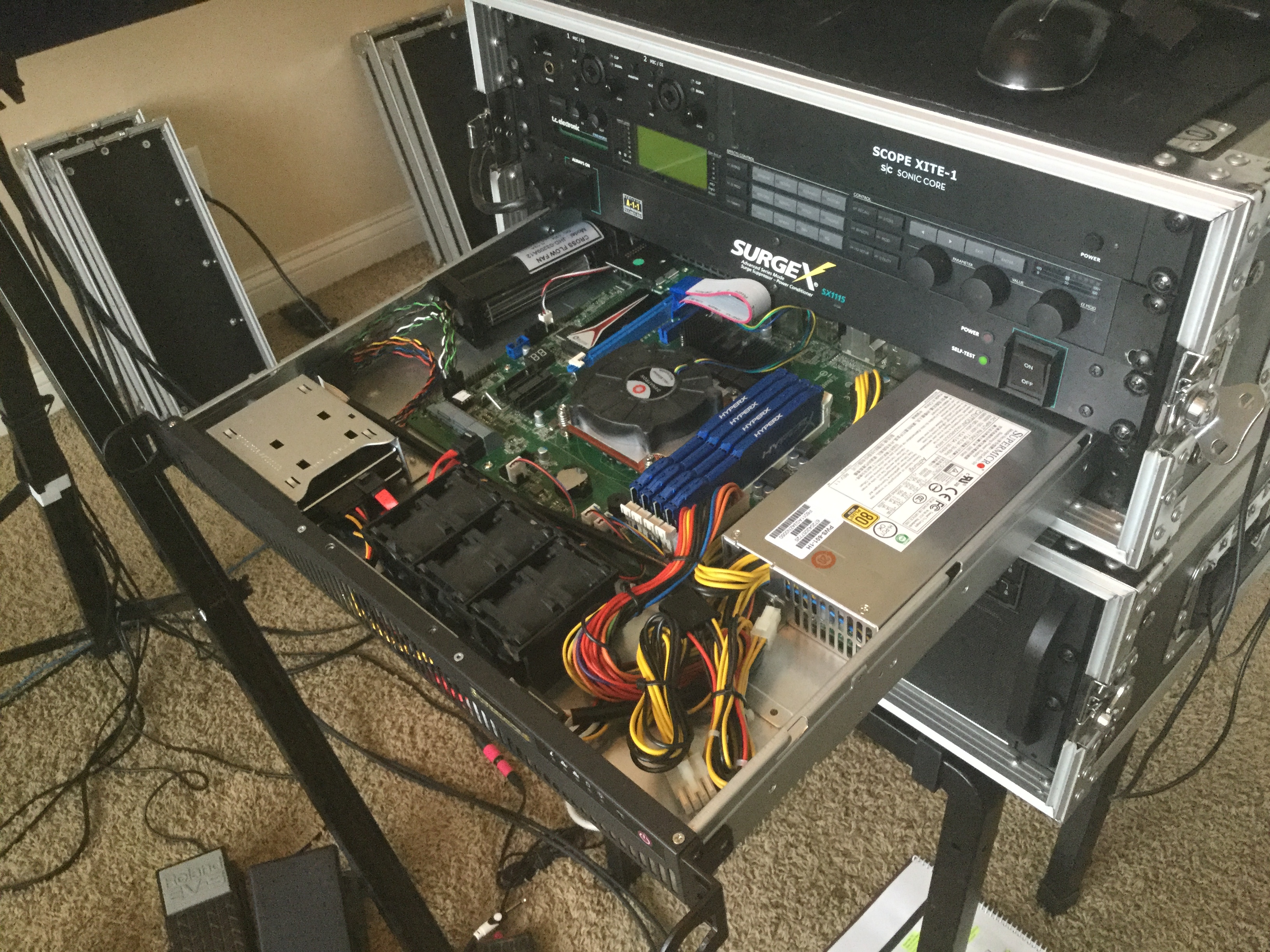

by dawman
I use PCI 3 (blue) and a PCI-e 4X slot for my S|C Connector card.
Fits fine, works fine, and due to the chipset/CPU Design Audio doesn’t go to the PCH but direct to CPU.
H97/Z97 chips are a unique/rare design stage where M.2s were @ 768MBps (PCI 2x speeds) so Phison E7 Controller Based devices are perfect.
We run into problems with boards that have more PCI Lanes that are unnecessary, that run at 1800MBps or higher.
These can be disabled in device manager though as they are pretty much useless except to load samples, rather than stream them.
STS or NNXT, Omnisphere, Love M.2s. Kontakt.....will overheat your PCI 4x M.2 making it throttle down to PCI 2X speeds anyway. Right back in the safe zone
Notice my E7 NVMe has a side blower fan to keep things stable.
You can also see the blue level 3 slot, and notice it’s a 4x.
Ankyu
