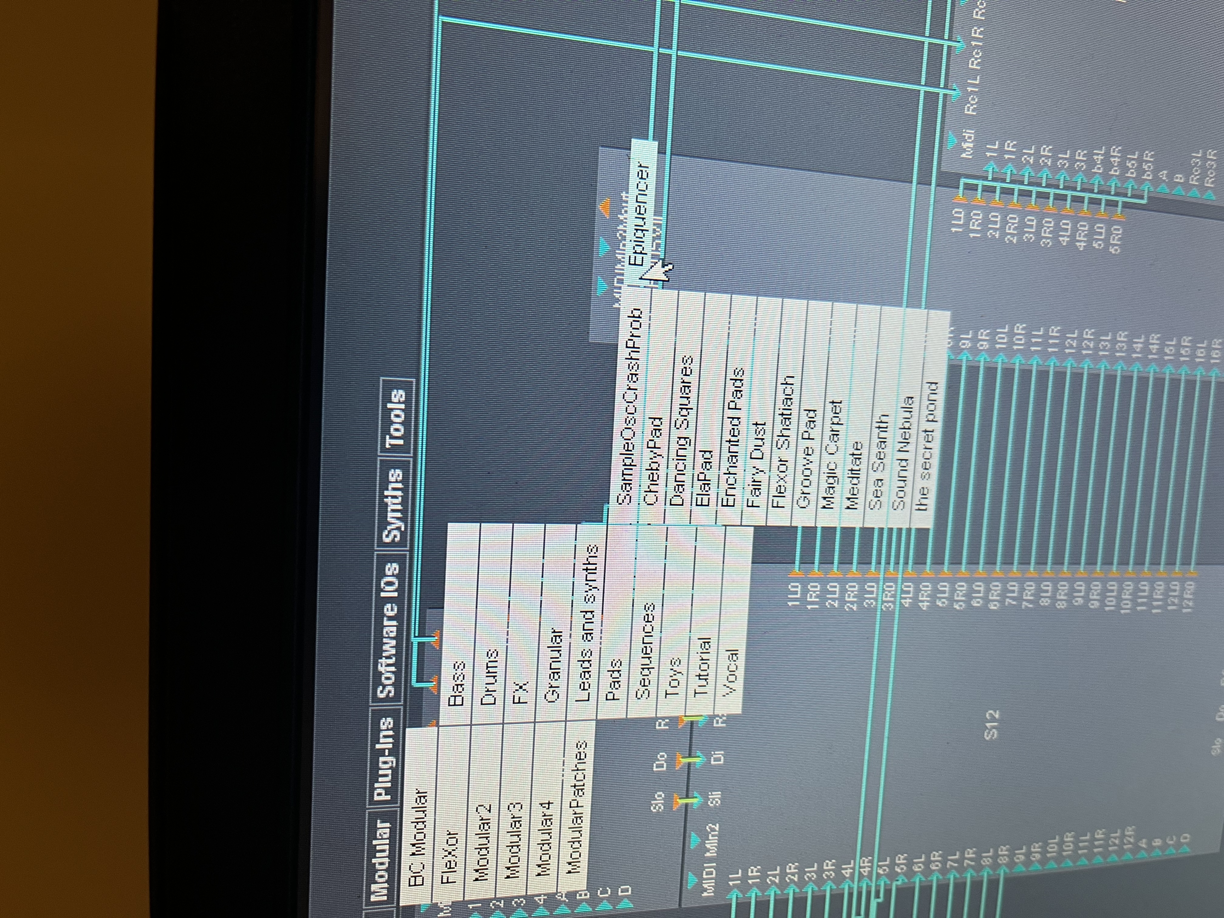

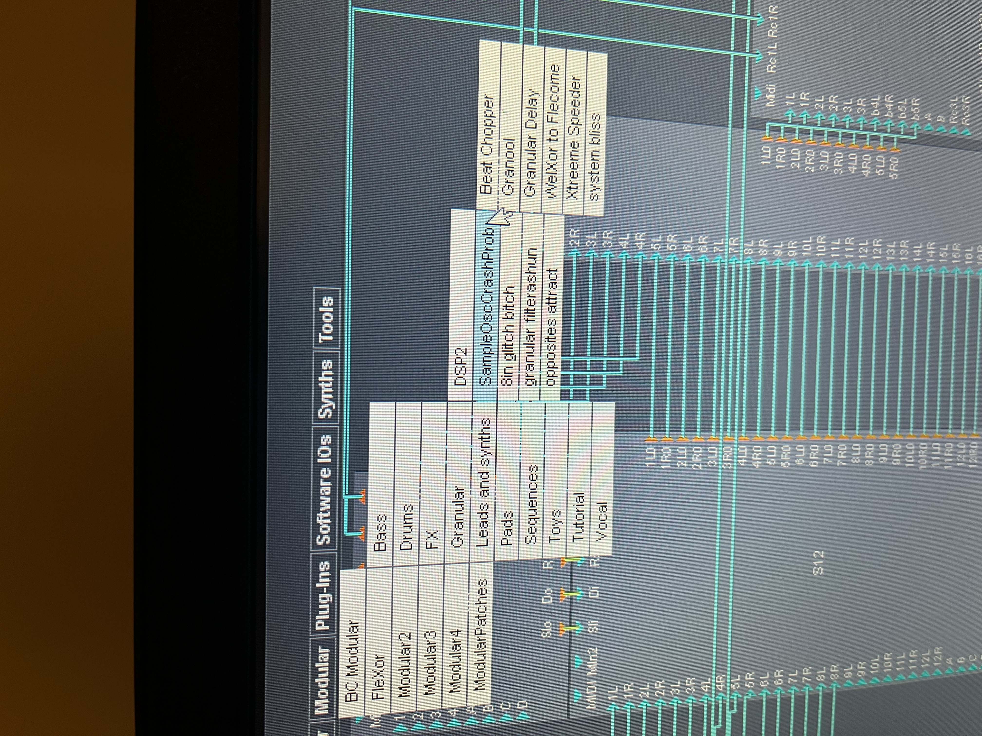

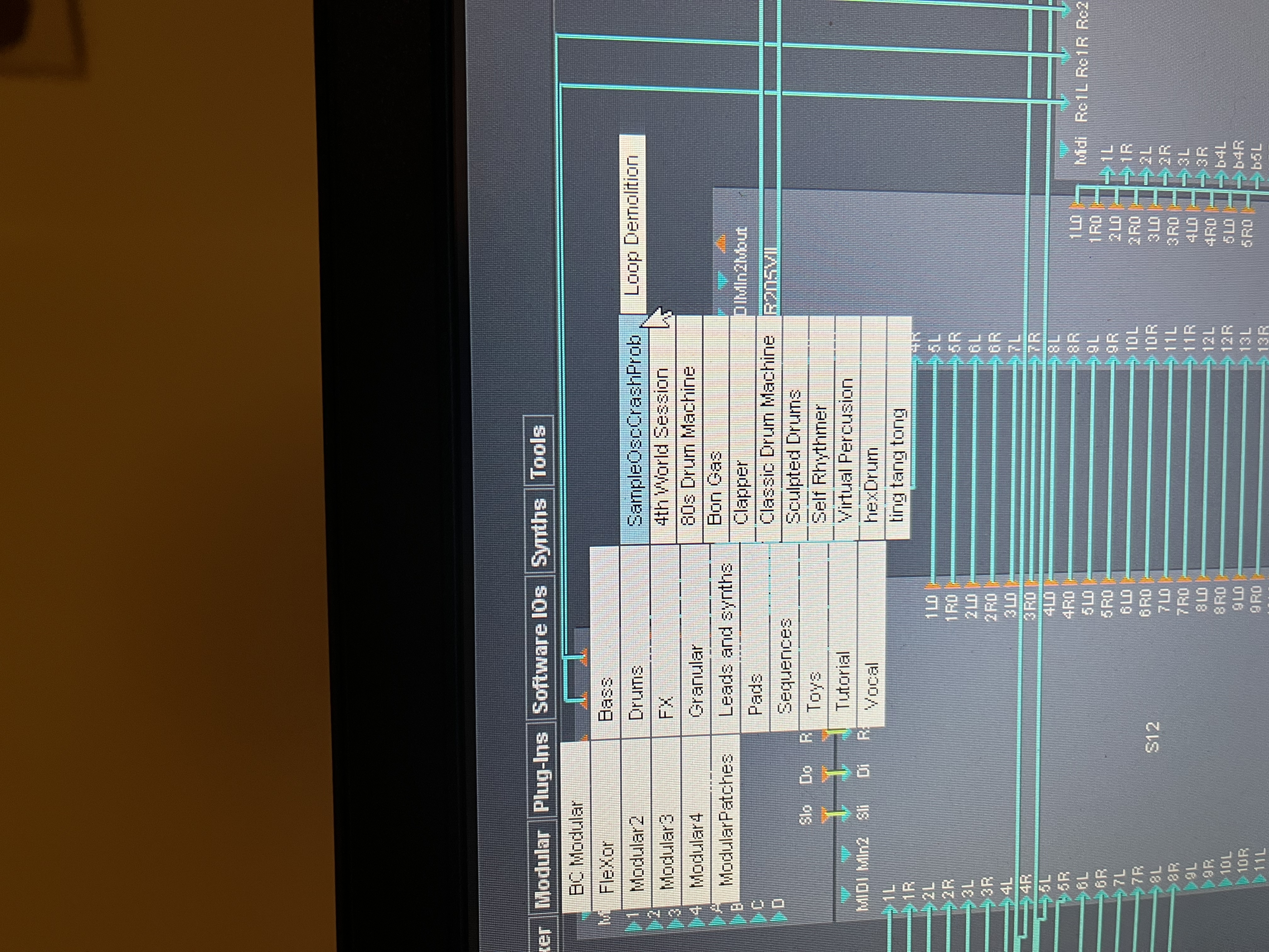

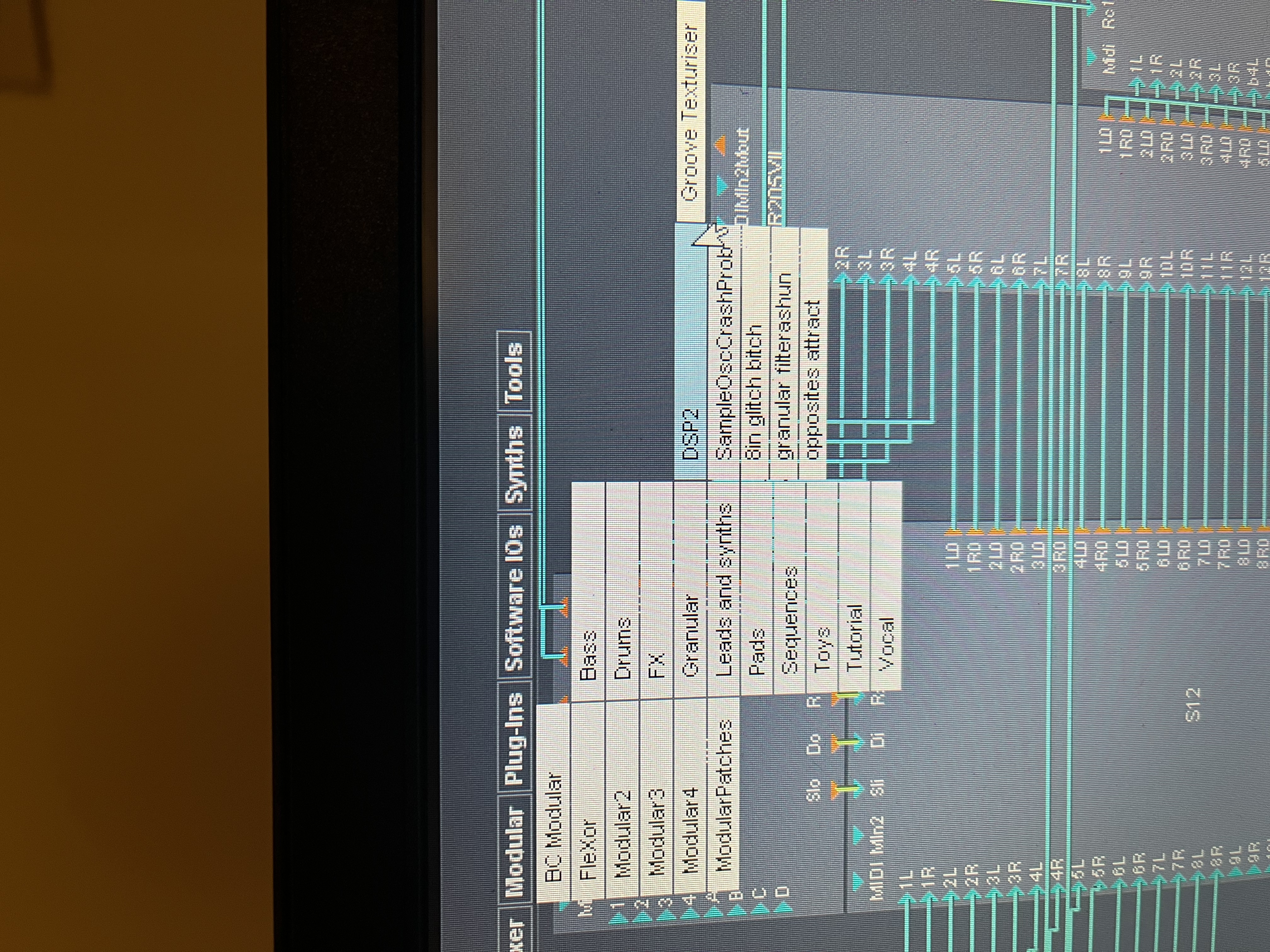

Here are the patches to avoid!
The patches under DSP2 don’t crash the system but contain seq modules that don’t update unless you do the 0 voice back to whatever voices you were using. If you were to get the seq modules into dsp2 they would work perfectly.
I’ll upload how I split the patch 808 groover as an example.
In the pictures, where the drop down list overlaps I’ve hi lighted the last patch in that list with the mouse curser.
I may have missed stuff. But you shouldn’t experience any crashes avoiding these few patches I’ve pointed out.

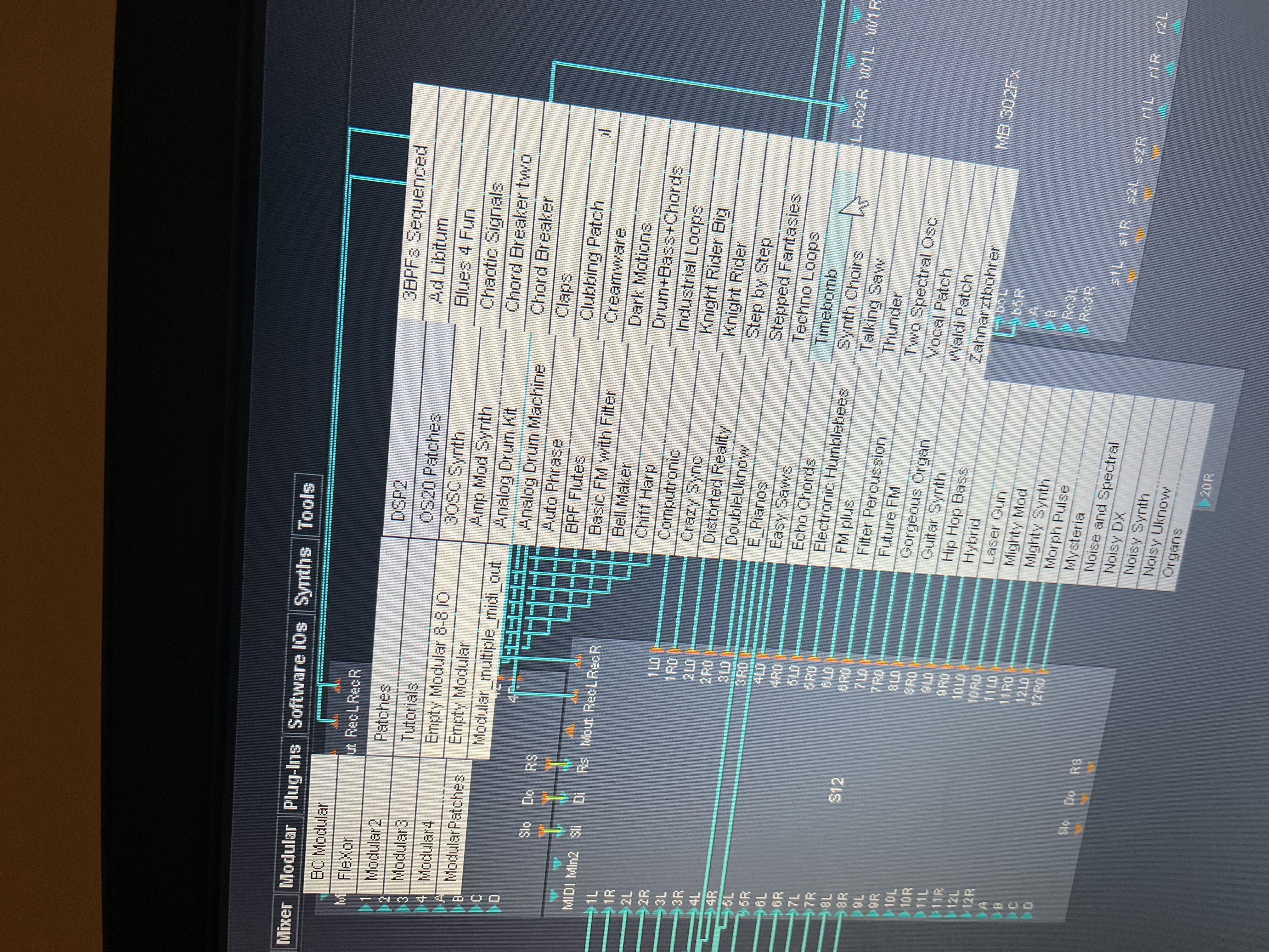

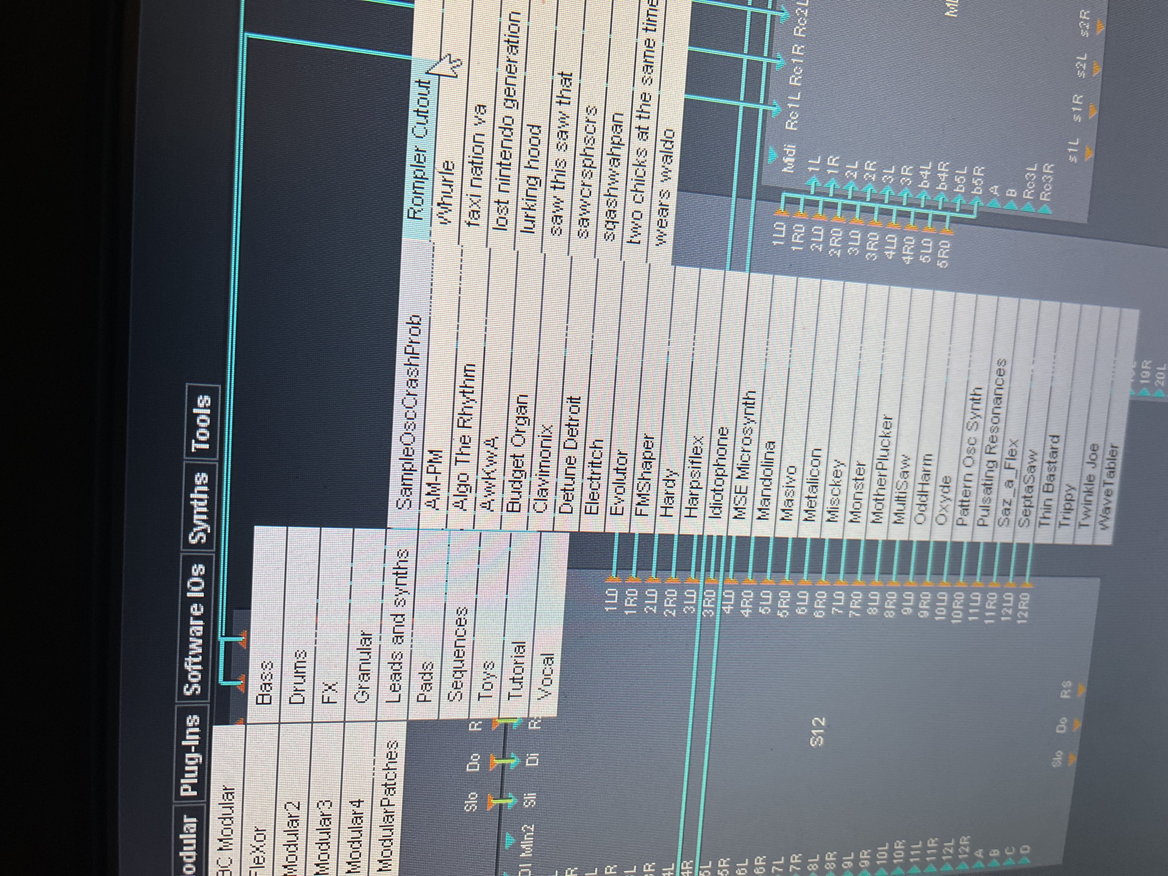

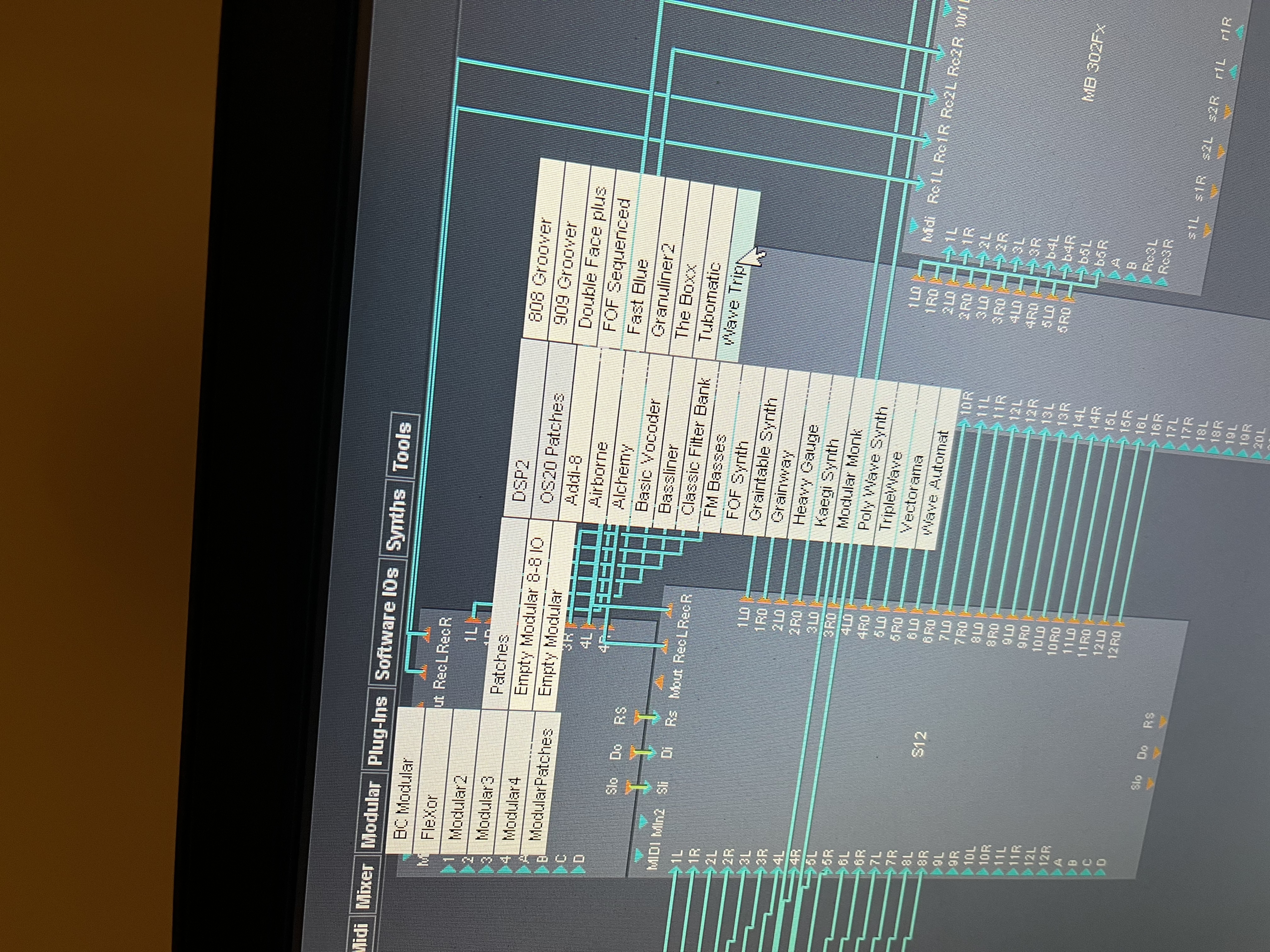

Liquid EDGE
Posts: 1205
Location: Brighton England
Re: LiquidEDGE Xite tips. How to avoid annoying stuff!
Post by Liquid EDGE »
Some more!
