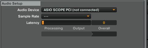

Hallo and good morning,
@ripper:
Go to services ->Restart Audio Service and Windows Audio Endpoint Builder and check if it fixed the issue.
--> Done but unfortunately did not solve the issue.
@Gary:
did you change the ASIO driver while your audio app was open? the ASIO drivers need to be in place BEFORE opening your sequencer.
NO.
also, we cannot see which ASIO dest module you are using. the ASIO source and dest modules much match and both must be present.
Previous to this issue only the Asio source was in place (and during the re-installation/testmode activation), simply due to the rerason that I need (on this PC) only the play out path. Base on your recent post I added the Destination as well but it didn't help.
what do your sequencer's audio settings look like?
It's onyl a DJ Software called tractor pro by Native Instruments...

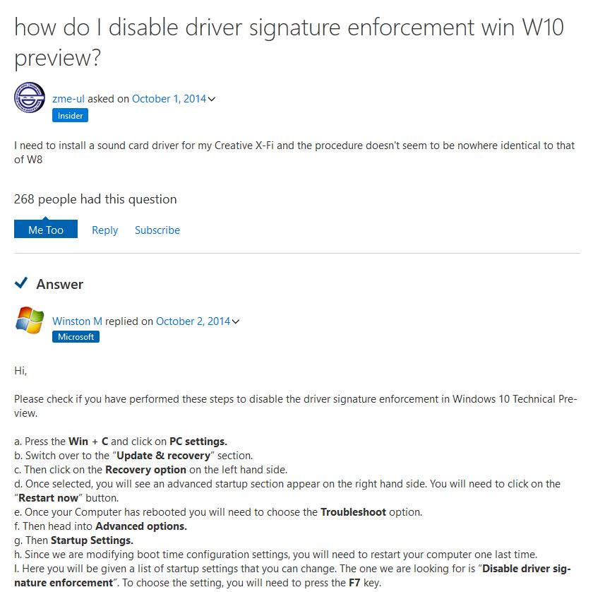

Hello guys,
I have the same problem since Win10 update, but I am not able to fix it with the testsigning tip, even as admin. Do I miss something?
Thank you!
Victor
Brazda lui Novac
Posts: 87
Joined: Thu Mar 23, 2006 4:00 pm
Location: Romania
Re: Win 10 - scope driver does not work since recent update
Post by Brazda lui Novac »

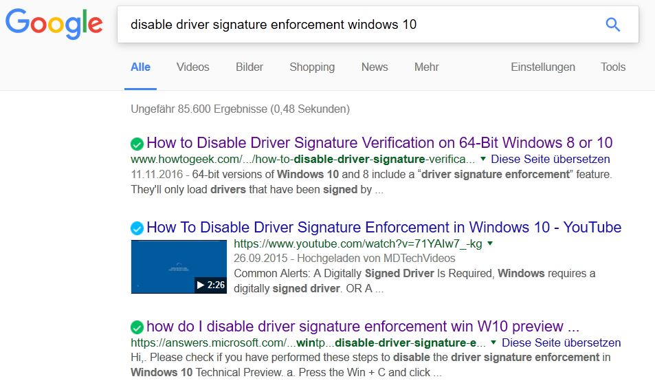

Nevermind, it worked finally with GaryB tip from the Microsoft website :)
Thank you GaryB!

Hi Victor, not sure which "GaryB tip from the Microsoft website" you refer to. Assume it is...
Refering to....
Tried that way as well without any change. It does not work. Just to make clear, installation executed without any fault and the scope application worked after re-installation. The only problem is the Asio issue.

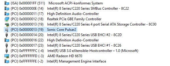

no, i don't know where to start. what is sharing an IRQ with the card?

No Gary, it is Tractor Scratch, a DJ audio application. Asio shouldn't work in the past....agree, interesting.
Here is the screen dump that might answer your question....
Posts: 23402
oh...
i don't know how well Tractor works with Scope. i'm pretty sure someone has used it.
the IRQ sharing looks ok.

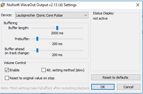

Posts: 23402
the "soundcard" driver is a leftover from windows 98. it was to allow playback from a soundblaster card into Scope. ignore this. it's not supposed to work the way you tried to use it.
other windows apps will use the wave driver. of course, you must make the Scope "speakers" the default playback device in windows.

I guess used the wrong terms. I meant the wave driver.

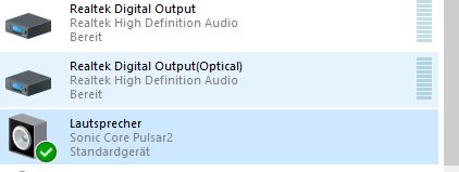

For example if If try to set Sonic Core Loudspeaker as standard I can do this but sound is coming still from the previous selected output (Realtec on board sound).
Using the winamp preferences dialog -> Nullsoft WaveOut configuration the sonic core loudspeaker appears in the device selection dialog.
.....but as soon as I select the scope driver I get the following after pressing play:
Regarding Asio4all I'll come back in the following post...

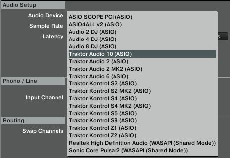

After installing Asio4All this appeared in the tractor:
After selecting ASIO4ALL v2 I get the following...
No failure from Tractor any longer. As you can see, Realtect and Pulsar appear in the list. Same behaviour...Realtec works and pulsar not.
The scope application still works wonderfull but to exchange sound between windows apps and scope app/card doesn't. Neither via wave nor Asio.
Btw in case put the mouse over the yellow symbol I get the following help text:
Any suggestion ?
