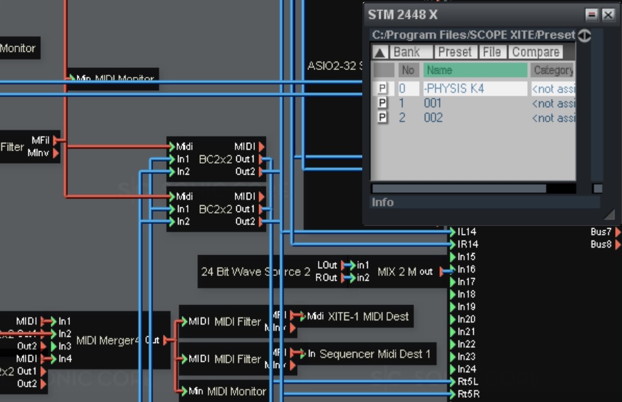

Re: Mixer SFP and MIDI
To keep from having to upset the natural order of synth presets years ago I always made sure my presets had a "-" so they would be first Bank.catscratch wrote: Are you talking about synth presets? I'm talking about cc assignments which can be stored as a preset in the mixer but that has never been reliable for me. I will be looking into your minus theory soon.
I simply carried this over to the MIDI CC Presets and eventually learned how to delete all other folders in my Live projects.
Other projects like stock, or editing, etc. are in an entirely different Scope Folder that I can always draw devices and presets from.
I stopped using the STM 1632X and went with the STM 2448.
Now I have not tried every little command like the compressors or bypass buttons.
Never use them, but if I do want to recall the settings I use SAL PRJ device since it also re routed my MIDI any where I want in real time.
But channels, mute buttons, solo buttons, AUX and BUS sends, all recallable every time I use them.
Even the Insert FX are all recalled properly and no need to load the FX CC Assignments manually...
- midi.jpg (117.51 KiB) Viewed 2454 times
