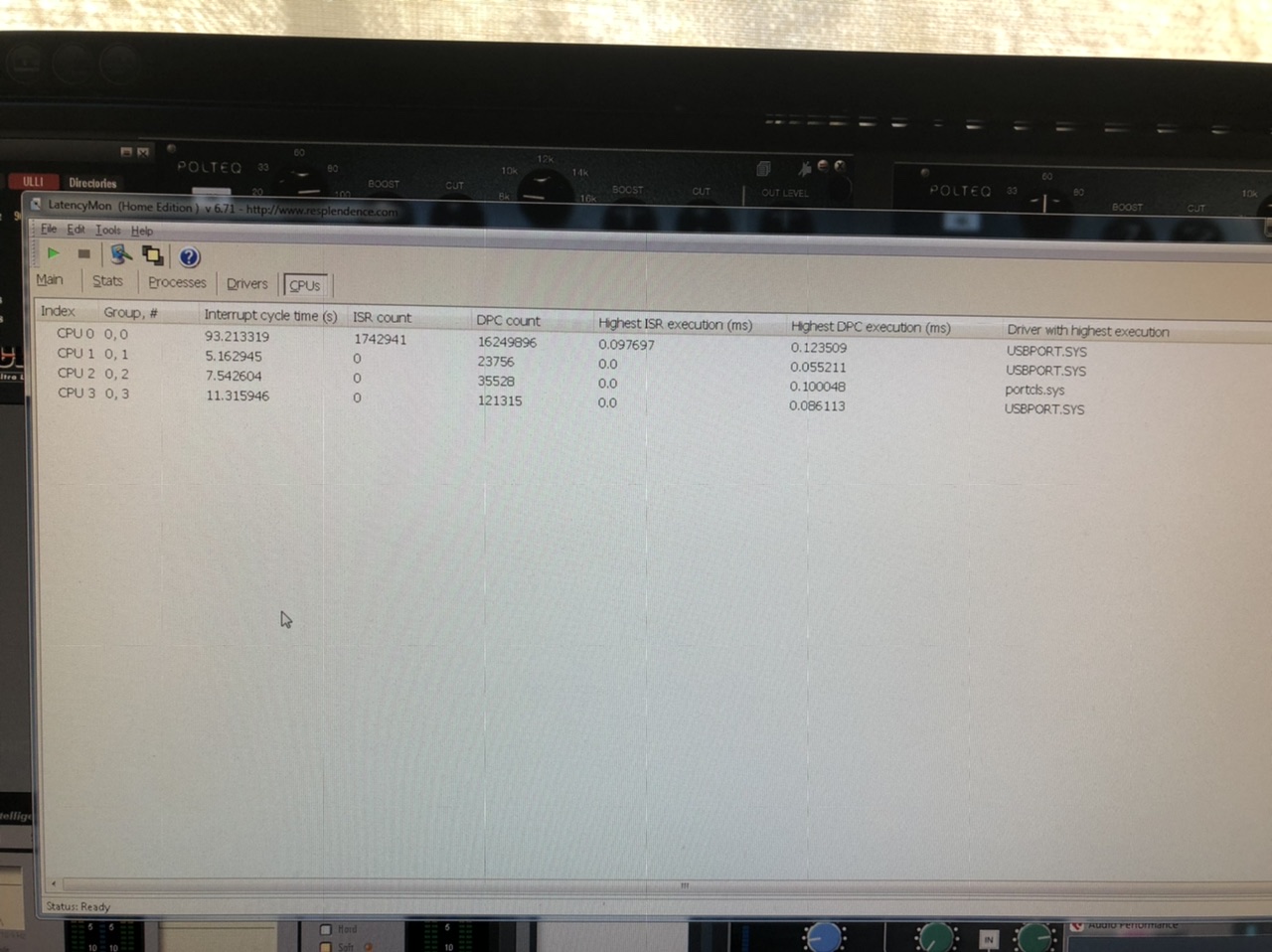

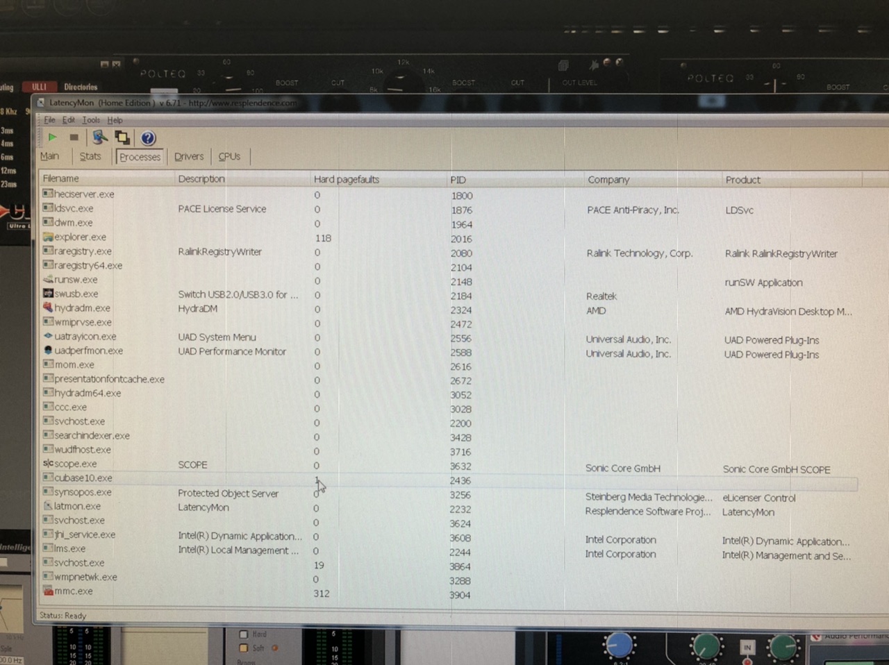

A few shots of my IRQ & Latencymon test result
IRQ’s
IRQ’s
CPU
CPU
Processes
Processes
Is it something to do with the USB?

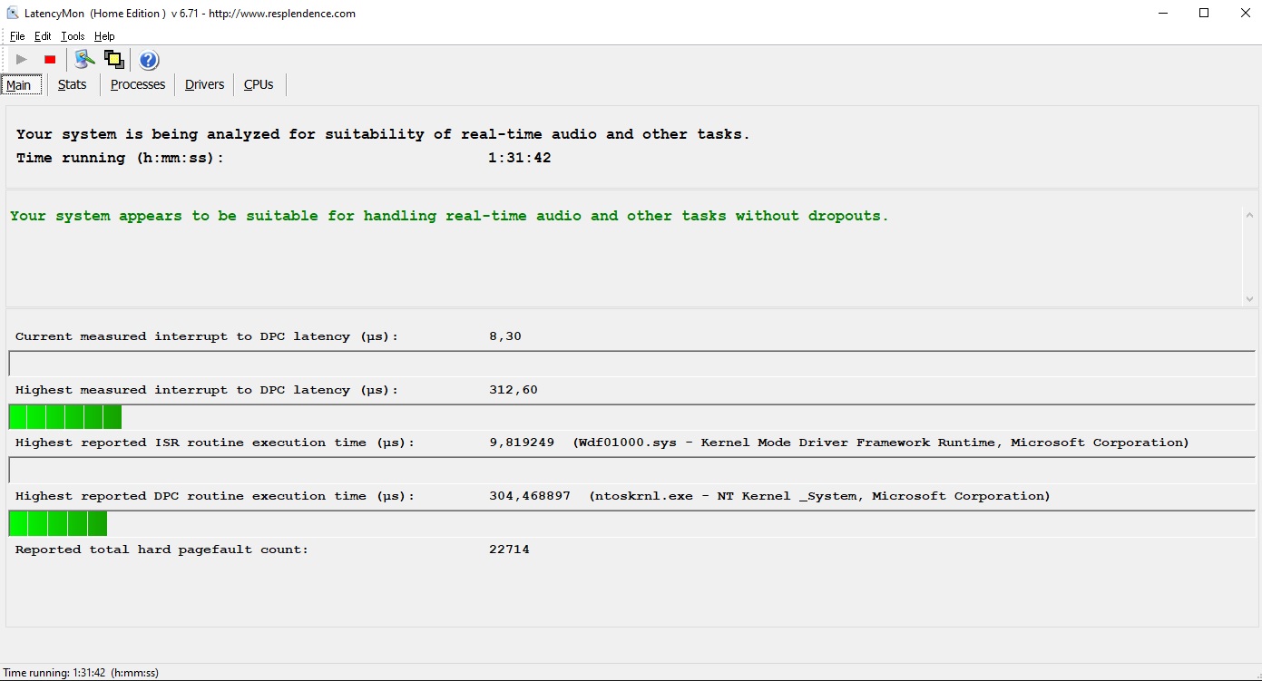

I have this USB hub for about a year. 7 USB sticks connected to hub (iLok, eLicenser, stick for waves serials, midi keyboard ... ).
I have attached printscreen for Latencymon, running 1 hour 30 min.
