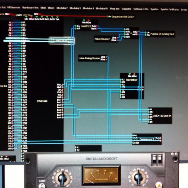

Before I head to bed - here is an example of my routing from earlier in the project
(When I noticed that bypassing the LA on the kick (when it wasnt even compressing much) affected the highs in rest of the mix for some reason ....).
(I took a snapshot, disabled the compressor and moved on ... But then realized the problem is probably phasing .... )
I will post sound examples tomorrow ...
In the pic you can see the busses (and nobus) going into the "second summing mixer" (the asio ins are just for resampling ).
Master chain is on top

Re: Mixing in Scope - Device latencies/phase problems
smaller...
Any chance of a re-size?
Also, I don't think it would make any difference in Scope, but why not use the ASIO2 modules trather than the ASIO1?

Sorry for the size - its straight from my iPhone ... I will resize next time.
I dont use ASIO2 because I dont need the extra features listed in the user manual (I think ...) - which is monitoring and stuff like that .... Would it make a difference with my current setup (I dont have any HW fx ... And I monitor my mic recording via Scope when I record vocals)
Im not really sure what is so "different/extreme" about my layout ... (All I wanted to do was group channels together so I can apply common effects like SC and bus compression / bus EQ .... Is that freaky ???
(I think I would be having the same problems if I didnt use the busses at all and just added fx to individual channels .... No ?
Sound example will be coming later today ...
