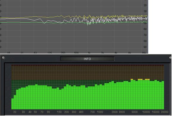

I ran some white noise tests (using the Modular NoiseOSC) (in mono setup and stereo setup)
pics:
Up to Down: Dry, MultiFX, 2A, 660
Left to right: Mono noise to stereo output, Dual Mono noise (stereo), 1/16th loop of program material
Up to Down:   Dry, MultiFX, 2A, 660<br />Left to right:   Mono noise to stereo output, Dual Mono noise (stereo), 1/16th loop of program material
I dont see anything I can put my finger on - but I DO think I hear sonic differences as in the audio clips I posted above (Please listen to them with good headphones / monitors and notice the overall spectral depth/height and extreme lows and highs)

I ran White noise via HPM control pack and got this peculiar output .... (There is also a reference spectrum added)
Pure WHite.JPG (35.58 KiB) Viewed 2731 times

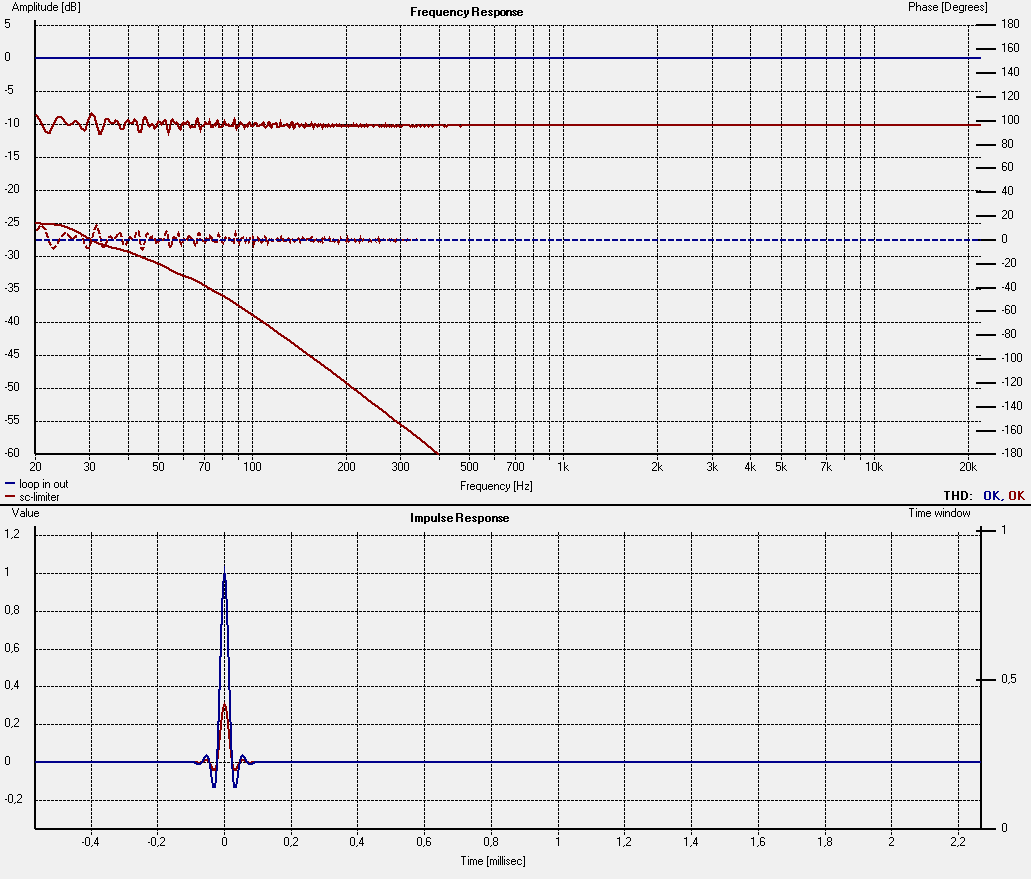

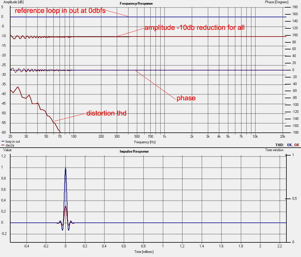

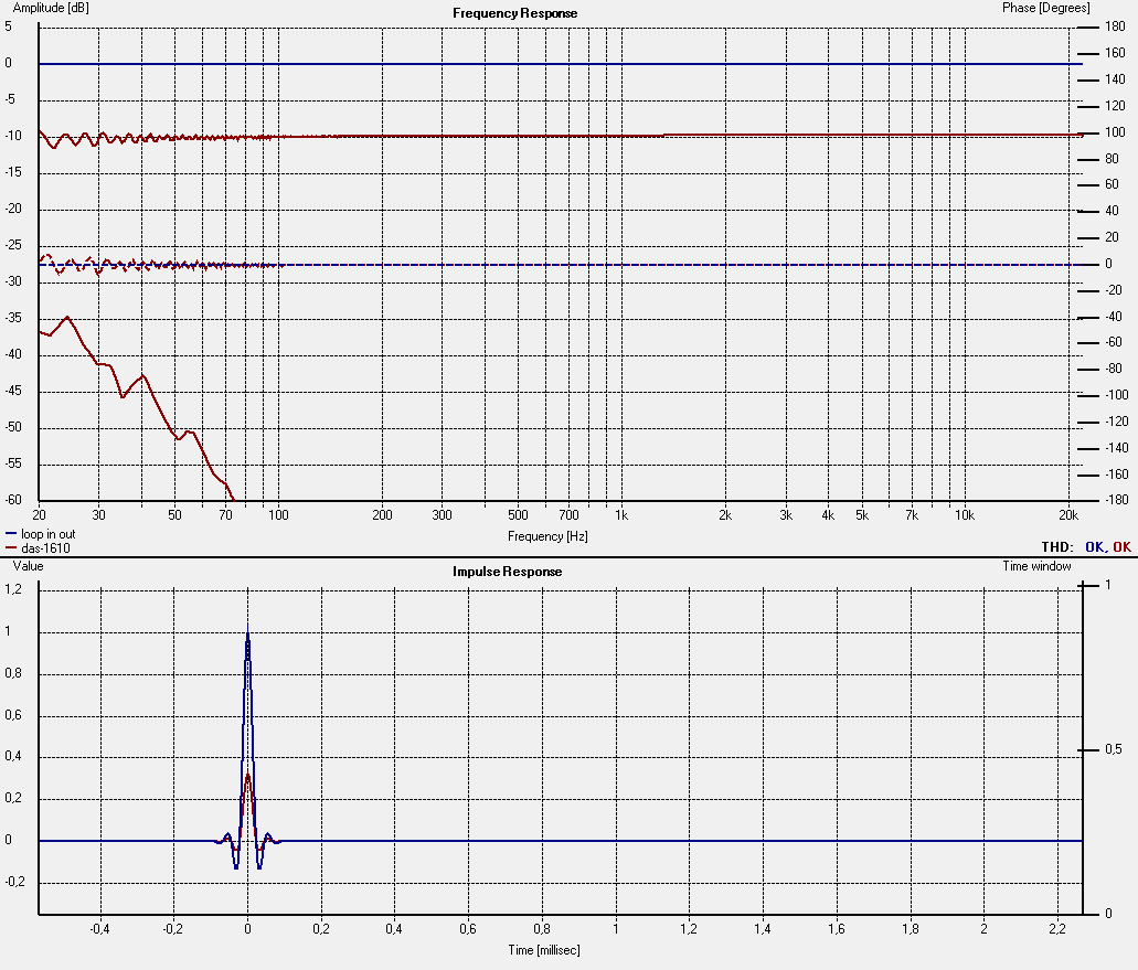

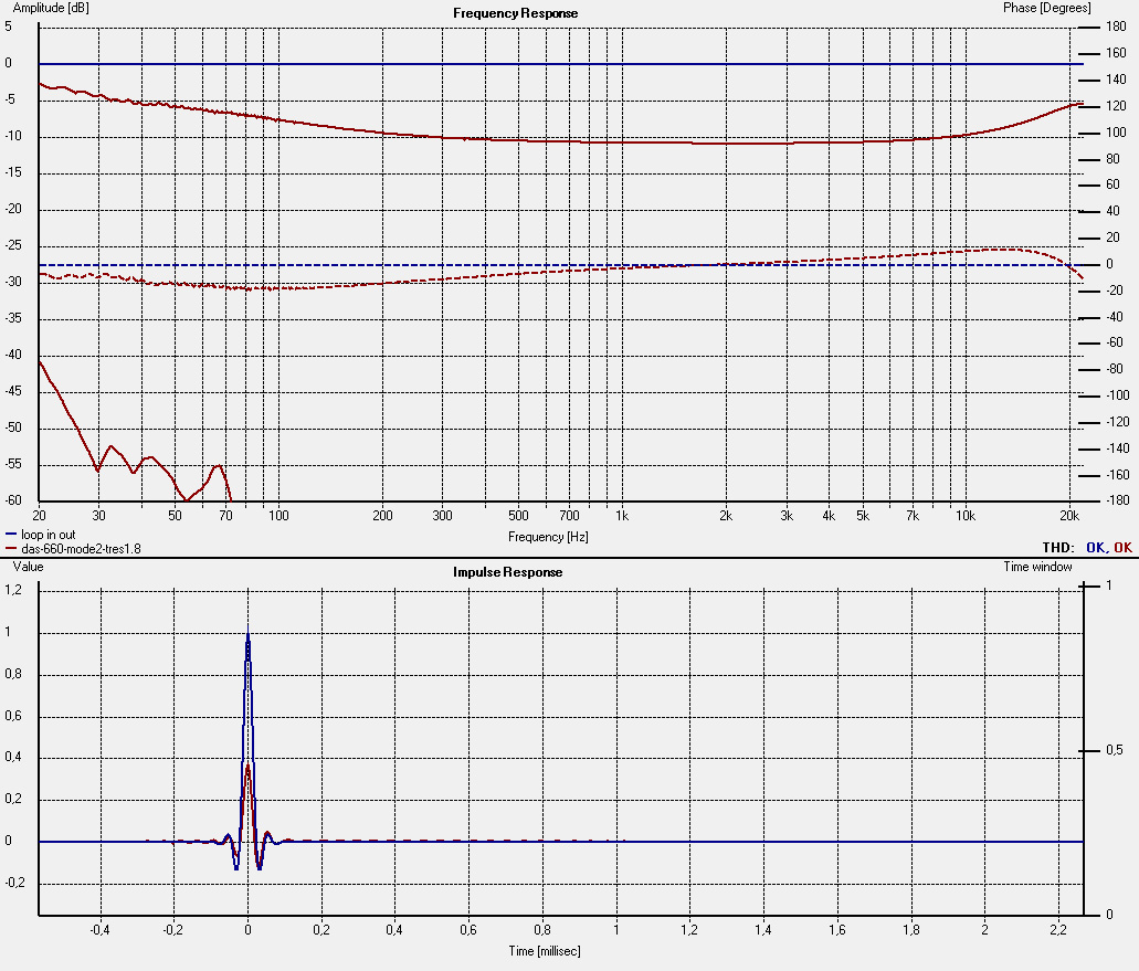

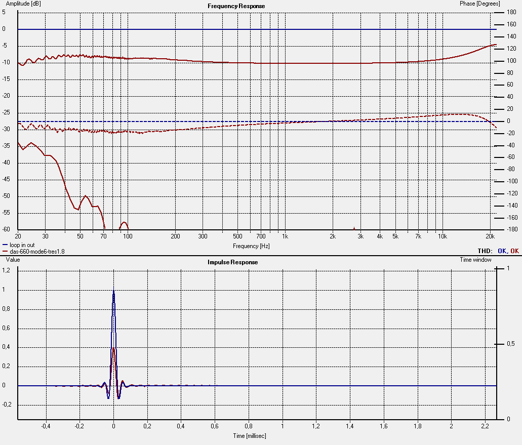

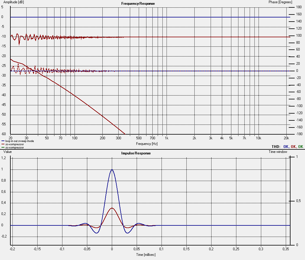

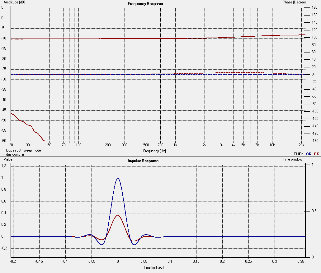

Re: DAS compressors and lowend stereo image / mid res
some tests.....
it all looks pretty normal.

Interesting Gary ... Not sure what to make of the THD curve (and why its only in the lows) - but it does seem like there are phase nonlinearities in the low end and a few spectral notches in that are to match (i am guessing that these could be more pronounced if there is a concentration of alot of lowend energy in a small band which has some of these nonlinearities (such as a tuned kick and single note bass) resulting in some cancellations (destructive interference) between neighboring bands that have been phase shifted (especially if - like in my case - all tracks (and thus lowend energy) is in phase originally ....) which could explain why i am noticing it more when phase compensation is turned on ....
One thing i didnt see is evidence of some sort of mid resonance (in wavelab i did notice some boost in the 200Hz area ... Will upload the pics soon ...)
Did you get a chance to listen to the audio i sent ?
Which compressors do you use on your masterbus ?
no processor, ESPECIALLY a hardware one, is ever going to be 100% transparent. there's no reason to expect software to be any different, nor is that needed.
yes, i didn't hear any problem in your samples, but it's possible that i'm not listening to what you want me to listen to.
compression on the masterbus? optimaster, and various master limiters.
depending on the source material, it's very possible that you might see a boost in certain frequencies, with any compressor. a compressor works by making to loud sounds quieter and the quiet sounds louder....

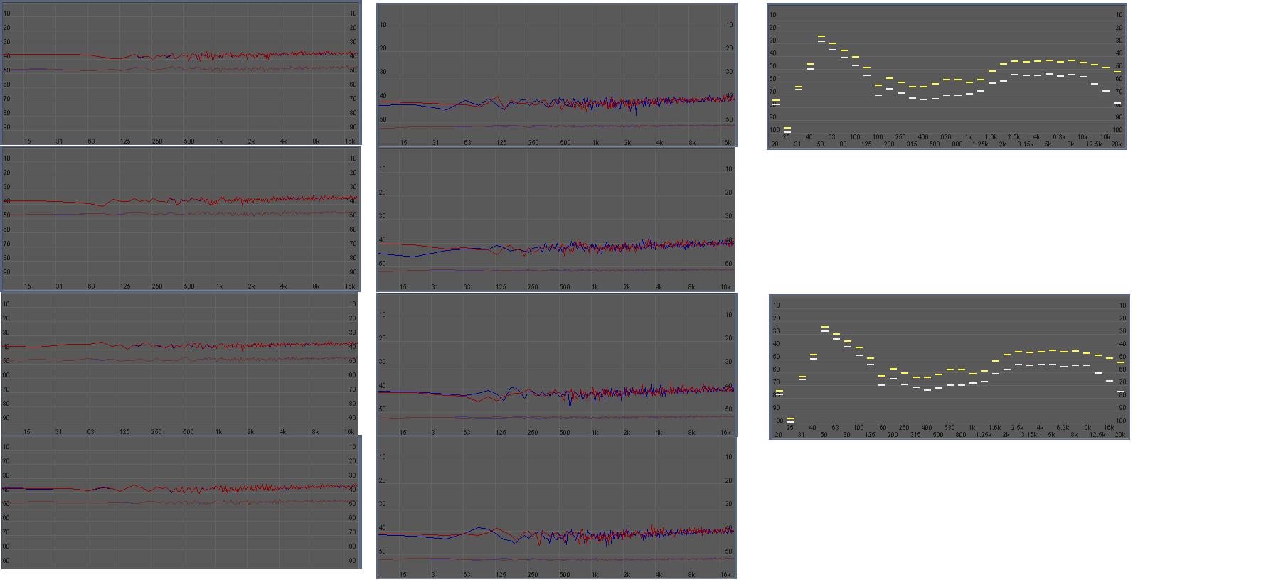

Not very easy to notice - but there is a bit of attenuation around 50Hz and boosts around 200 and 500 in sections 3 and 4 (out of 5) especially ...
Which correlates to (- or subjectively influenced by) what I hear ....
Spectrographs.zip
(794.38 KiB) Downloaded 107 times
