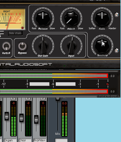

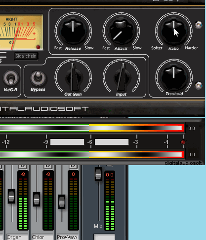

I think you are right, I forgot to turn of other devices before AI Comp in mastering chain. Now it behaves more conventionally. Tests this gif shows :
1) Both Ratio and Treshold at 12 o'clock. No Gain Reduction.
2) Turn up Ratio. Gain Reduction occurs.
3) Reduce STM output. Gain Reduction disappears.
AI Comp Ratio Test
AI Comp Ratio Test
Conclusion : There is an output level on the STM which will make your statement of just turning up Ratio without touching Treshold introduce Gain Reduction. This to me is an expected result - no surprise. The Ratio increase is simply responding to the 12 oClock threshold level in combination with your input level.
Posts: 5052
Re: DAS AI Electronik specs
Second test : Shows Treshold turning fully right (clockwised) increases Gain Reduction.
AI Comp Threshold Test
Conclusion: Treshold knob orientation seems to be the reverse of other compressors.

dante wrote:There is an output level on the STM which will make your statement of just turning up Ratio without touching Treshold introduce Gain Reduction. This to me is an expected result - no surprise. The Ratio increase is simply responding to the 12 oClock threshold level in combination with your input level.
No surprise ? Is it so often in compressors ? Maybe in others, it's less visible, cause I don't know other one or I never noticed it... :D
Anyway, I'd like to know exactly what is the relation between them.
Agree !

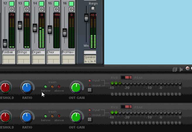

Heres the DAS1610++ doing the same thing - threshold and Ratio at 12oclock - no Gain Reduction. Turn Ratio up - Gain Reduction.
DAS1610
DAS1610

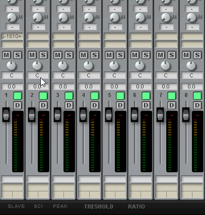

JoPo, here is test I made w/ DAS 1610 as an insert, turning Side Chain On and Off. No bluescreen here.
DAS 1610 SideChain
DAS 1610 SideChain
Is this the right test ?
