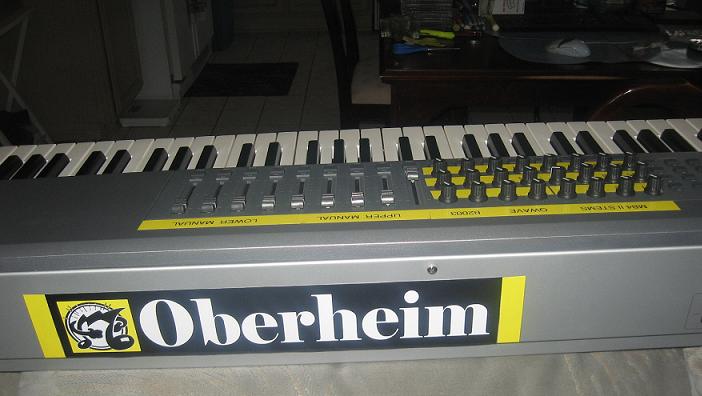

I can't trigger a dozen velocity layers with it but I use a PhysMod PianoTeq Pro 5 for it's editable Upright and D4, plus the smokin' Wurlitzer 200A.
Even though I love my Casio I am embarrassed to be seen with one so I changed the name, and everyone always comments on how great the Moog sounds.
I love the PX-3S action even for external sounds.

Re: Which is the best "real piano feel" keyboard out there?
Did the same thing for the lame ass M Audio.
People loved the sound of my Oberheim....
