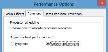

Did you do this re background services ?
And what is ULLI set to ?
Re: pops and clicks xite -1d windows 7 64bit
Posted: Thu Mar 06, 2014 8:43 pm
by ShogunSpy
Thanks Dante. Yes I did and thanks for your webpage there's a lot of good info there.
