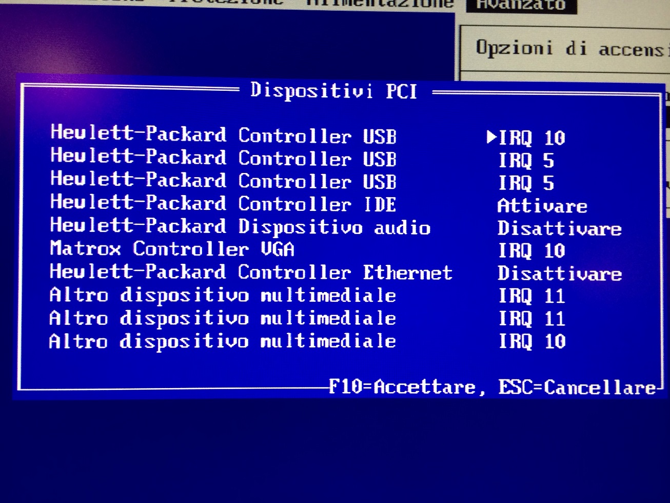

Posts: 23412
Re: Clicks and pops in two adat ports...
that pic is not useful. irqs are not handled in the bios and haven't been for a few years now.
you need to check system information in windows, hardware resources\conflicts/sharing....

garyb wrote:that pic is not useful. irqs are not handled in the bios and haven't been for a few years now.
Mmm I believe my pc is in pC standard mode, not acpi...
Are you on xp or win 7 and which version of that?
ACPI Is what you should use.
Edit: You need xp pro or win 7 pro to support dual socket boards.

3) I disabled the usb port that shared Irq with one of the Pulsar2 cards and the graphics card.
4) I disabled "reset card if idle"
Result: One of the adat ports still doesn't work...while the other one (on the third card) seems to work (but I tested it only for one hour)...
The card in which sits the "broken" adat port is the only one that shares irq with the graphics card, an AGP Matrox G550. There 's no way to disable that sharing, no way.
