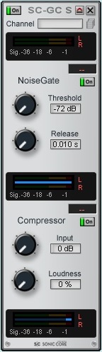

Thanks again lads. Im also looking at the combo version of this device, where a gate is included as well. Im assuming signal flows from gate then to compressor.
gate and compressor combo
What I'm thinking about there is the relative merits of whether to apply this affect at time of recording, or on mixdown.
For example, having a gate during recording might risk some parts of phrase attacks or bits of softer phrase getting cut out too late or early. So having the gate applied after recording allows for finer adjustment.
On the flip side, at record time, a well set device and predictable vocalist means the track goes down clean and well compressed with no need to muck around later.
Any experiences on this ?
Re: SC-C S Compressor - when or how to use ?
Always record straight, use as little processing as possible is my motto. You can leave enough headroom these days to not use compression - maybe just a little limiting for a singer not experienced in mic technique but that's about it. Definitely wouldn't go near any gating, much better to have the noise, easily edited out these days in your DAW.
I see this as as an OverEasy type compressor (gotta love that 'More' slider).
Mr Arkadin wrote:Always record straight, use as little processing as possible is my motto. You can leave enough headroom these days to not use compression - maybe just a little limiting for a singer not experienced in mic technique but that's about it. Definitely wouldn't go near any gating, much better to have the noise, easily edited out these days in your DAW.
absolutely good advice!
with a few specific exceptions, only a bad engineer records with gates and compressors. about the only thing i'd ever gate while tracking is tom toms that are close miced and even then, i might not. remember, once processing is recorded, it's permanent. it's better to process later.
