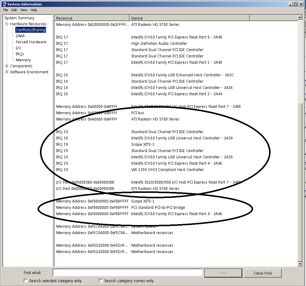

Thanks Eanna,
I have a few conflicts worth looking into!
I am concerned about the USB Hub and controllers on IRQ 19.
Also I note there is memory sharing, but I don't think its that at this stage.
@Dante
For the record I have 12Gb of ram
Maus

OK, not sure what you can do about the Memory, but yeah follow the steps on the previous page to find what USB devices are connected to those USB Host Controllers on the same IRQ as XITE by using the Device Manager "Devices by Connections" view. Be prepared to unplug those devices, and disable the USB Host Controllers thru the Device Manager.
I also notice you have a VIA chipset Firewire controller (OHCI) on the XITE IRQ. Do you have a Firewire device connected? On my last PC, I had no end of stability woes with a Firewire Audio Interface that in retrospect I could probably have solved using these techniques.
Since you've an Xite, guess you have a Card in a PCIe slot that looks after Xite comms. Is that card listed on your same IRQ 19?
If yes, then before you do any of the above, I think you should consider moving Xite to another PCIe slot. Remember, a small-connector PCIe can fit into a large PCIe slot... Restart your machine, and check for conflicts again. You might end up sharing Xite with fewer devices... Since IRQ 19 is shared with the IDE controllers, the interrupts for your Hard Drive may well be too much for Xite to live happily with..
(Me, I didn't have the option to move my Scope PCI cards, since my motherboard has only two PCI slots...)

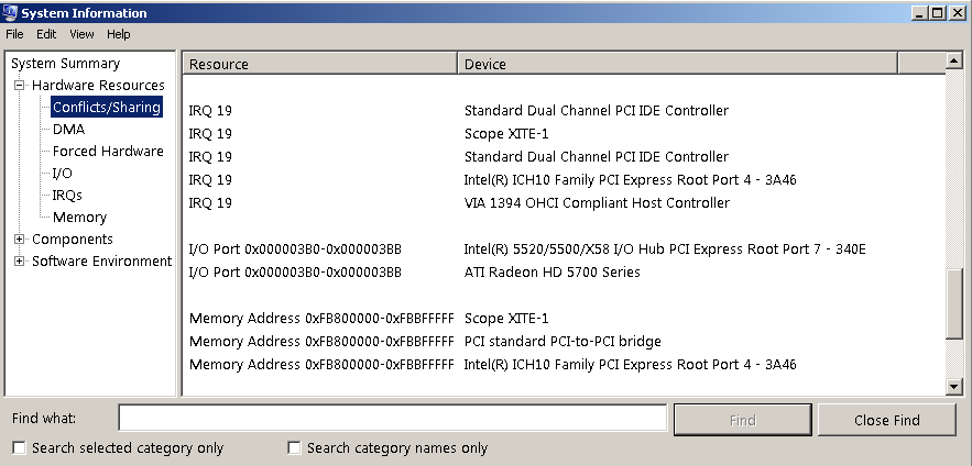

Re: Q-Wave BSOD's
Hi There,
XITE-1 hardware is on a different IRQ.
I have disabled the two USB nodes on 19.
One was a codemeter for my old Yellow Tools Independence Sampler. Interestingly it has been reporting that that codemeter is not running for months.
I ignored it pretty much as nothing seemed to be disabled (Independence now runs in Samplitude and is working fine).
I removed the codemeter.
The other was 4 port midi box that I have re-routed to another USB port with a different IRQ.
Started SCOPE after reboot, all seemed well.
Ran Q-Wave and was able to change presets on the main instrument OK (so far).
Tried to change Performance Preset and bam BSOD!

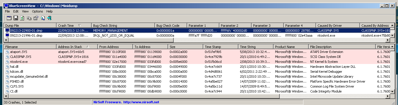

Re-booted and without doing anything except playing an odd note on Q-Wave when it opened, Changed a Performance preset and BSOD again!
Interestingly this time minidump reports the cause as 'Memory Management' whereas previously it was 'IRQL_Not_Less_Or_Equal'.
The Firewire is the next target.
It links to my M-Audio ProjectMix IO that I use just as a controller.
I will disable and see what comes from that.
Thanks for your help
regards
maus
regards
maus
Re: Q-Wave BSOD's
Disabled the VIA 1394 OCHI Firewire.
Still get BSOD's.
A good thing to get away from SCOPE interrupt though.
Still get BSOD's.

Re: Q-Wave BSOD's
Its not just usb devices that could cause the flow of data to scope to be interrupted.
Dante, what shares irq with scope?
And maus, what firewire device have you connected? The via ohci device is your firewire host hardware driver. Even temporarily, can you disable that, and retest? And, do you have the option of using a different slot for the xite card?
It may be worthwhile to consider checking for dpc latency on your systems too - especially those with firewire stuff.
Edit: sorry I see you disabled firewire..
Is there any option to change the slots for the xite card?
You may be able to adjust memory sharing by switching off dma, but I have no idea if this is generally a good idea or not, so best to do a bit of research. Here's a how-to:
http://windows.microsoft.com/en-ie/wind ... -on-or-off

I would recommend the usb approach, as I think you can choose to set it up to boot into the os.
Think the installer cd pushes you down a clean install.
Is it booting windows that's the problem? You can load the bios screens ok? You don't get beeping as you might if post failed?
Might you have changed from ide to ahci as part of the bios update? Or vice versa..
Such a change would probably stop windows from booting. Not ever come across it, but you might check that.
Your ide controller was one of those that shared irq with xite, so check if your bios is now set to ahci..
