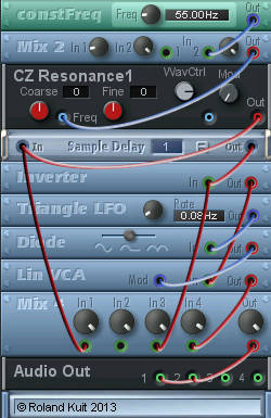

Allpass test 1:
Flexor Allpass mod.rar
(421.86 KiB) Downloaded 143 times
Roland Kuit Flexor Allpass mod.jpg (33.34 KiB) Viewed 2358 times
http://www.rolandkuit.com/

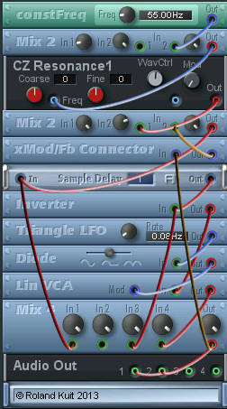

Flexor Allpass test 2:
Flexor Allpass mod 2.rar
(407.8 KiB) Downloaded 124 times
Roland Kuit Flexor Allpass mod 2.jpg (38.16 KiB) Viewed 2358 times
Re: SC Six-String
I think "technically" a sample delay is the same as a feedback module, but in reality they're not? Tgsgs might have a better understanding.
