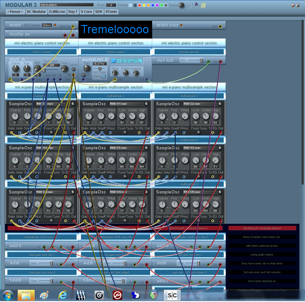

well i have proved that multisampling can be done on scope modular
and with great results
but people with 64bit systems seem to have problems with poly and sample osc
jimmyv just beta tested my e-piano multisample instrument
and on my 36dsp system i can get 20 notes poly no problem on a p4 3.2 single core no ht with 2gb memory xp32 sp3
but he has problems on his xite which is much faster than my 36 dsp system
with 64bit only getting 4 note poly which defeats the object of an e-piano
the rmi is great as 10 notes is enough poly as the sustain on these is not very long compared to a acoustic piano
but one sample osc with a keymap function would be so much better and the modula dev would be tiny
compared to the amount of modules needed to do it now
rmi modular dev.png (432.95 KiB) Viewed 4858 times
this picture is from jimmyv 64bit setup and xcite
i cant wait until scope 6 comes then i can embed in the samples so you dont see the sample osc for instruments like this and only have the controls on show needed for operation
