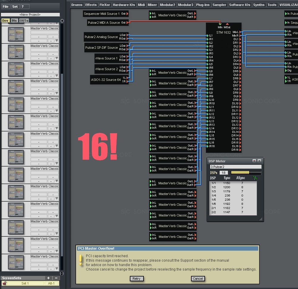

Update:
- Core2Quad Q6600 50€
- SSD 120Gb 99€
Fresh installation of XP
in the moment without special DAW tweaking
16 Masterverb classics :D
Number 17 causes PCI limit :)
