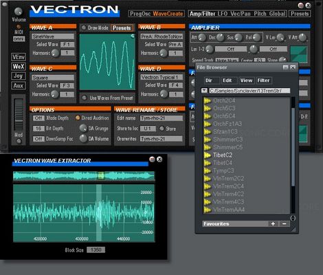

Back to you ASR (which would be my preferred choice for a keyboard/sampler btw):
If you KNOW how the scanning of the waveform works, there is a fair chance that it can be done in SDK.
But you need a functional understanding of the oscillator(s).
There is a somewhat similiar function in Vectron (I guess), where you can pick segments of the existing waves to build new ones.
As we're at it... I'd never port anyone's C-code for porting sake, I'd always analyze the method instead.
(which may be difficult to impossible - depending on source)
I didn't even do that with some of my own stuff, when a system got outdated - I trashed it and rewrote.
ps: don't expect your project a big success or a major point of interest. Such stuff has a very limited customer base.
it's cool if you want to work something out, but both more profane and more sophisticated ideas have turned out complete economic failures in this environment. Sadly...

well, as it got me curious I tried the 'custom wave' thing with Vectron...
it's not that intuitive for a start without reading the doc - but one gets along, the most important point 'alt-double-click' into the Wave-Extractor's bottom area to get the faint blue region.
This is immediately taken to the Wave Create display and you can play and tweak it in both screen areas, for example shift the frame through the waveform and adjust it's size... etc
The envelope allows pretty long setups, too. Anything missing ?
- Vectron.jpg (44.55 KiB) Viewed 4493 times

Re: synthmaker
vectron is good but much better to add single cycle waves instead just like the real pro vs which were 8 bit at the time
but with vectron they are static single cycle waves and dont change over time
but becuase of the vector joystic are able to move from 1 sound to another thru volume mixing and if you set different pitch settings can get great fat patches and in unison mode great sounding sounds
this is complex additive synthesis as you are adding 4 complex waves in a volume morpher
now if only they added the pitch vector like the sy35
i can do this in the k5000 as i can take upto 4 complex 64 additive bands and can mix them with a joystic
