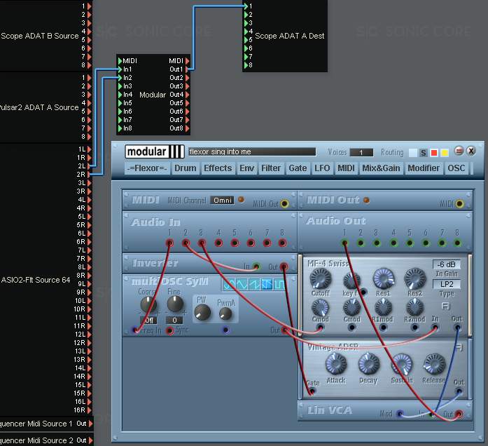

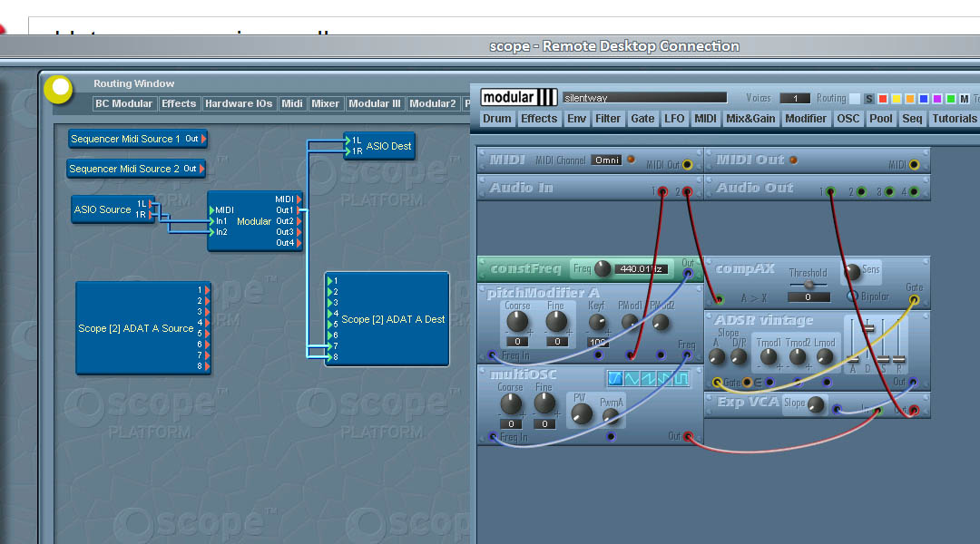

Re: Successful Full Range with Silentway Voicecontrol
back to the question of getting scope modular to get full range, here it is
it can be calibrated right from silentway voice controller as well.
Here is a simple example of
how i got full range on scope modular with silentway.
you can use the gate to multiple envelopes without esync,
and i looked at the silent way calibration text, and it has negative values, that is a good thing because it can use the full range of the output and the hardware offset/amplifier is easier to make.

looks nice, though you dont need those modules, simply connect output 1 of silentway to the freq input with the calibration txt file I supplied
for the gate I used an inverter I guess, gotta have to look it up, just found out a mayor issue with sfp5, i cant load older projects, he asks me for the registration of several plugins like sts5000, channel, stm 2448, and when I supply them he just wont load those plugins, I load an almost empy project, but thats another thing...

Oh, I wanted to do it using my own calibration, i had not seen that you posted that.
Anyways bad news for me, according to the data sheet the ADC in the fostex VC-8 "ak4522" has a digital high pass filter built in(for blocking DC
), which can not be turned off. that means i can not use it to input control voltages. CV out is the main thing, but CV in would have been nice.
oh never mind, it looks like it decodes AC which has been modulated with a VCA, so it ought to work, just means i have to waste an oscillator and as many VCAs as i need inputs,
