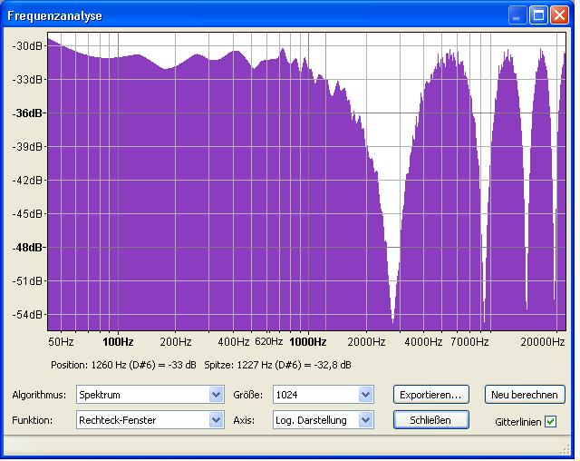

Post by tgstgs »
8 SAMPLE delay
edited to get not missinterpreted
sorry short in time
and i do not want to fill the server;
good vibes
WhiteNoise_8samples delay.JPG (67.59 KiB) Viewed 4204 times

Post by tgstgs »
and PLEASE let me add
independant from samplerate / bitdepth and taste
good vibes

YES,
you are right;
if talking about basics i should start with the term samplerate;
its true divisions of SR will have a different value depending on SR;
but its the same effect no?
and the topic is about phase remember?
these where FeedForward structs only so far_
im sure your FeedBack will have more Resonance;
now who if not you is the one telling us where to use such effects positive?
do we get some positive vibes from denmark?

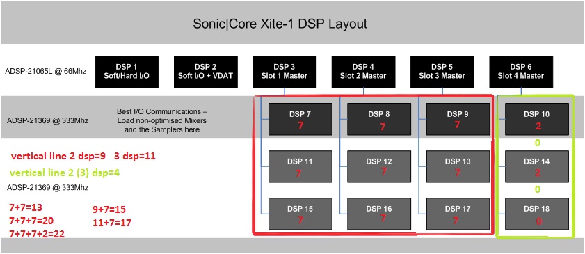

Re: PHASE
So does this mean that a 1 sample delay at 96khz would be less of a bad phase than a 1 sample delay at 44khz ?
Or are they both just a bad phase ?
Lets say we have a project loaded on XITE that has some barely audible phase issue at 44khz. Would it be less noticeable running the same project at 96khz ?

Re: PHASE
Post by at0m »
dante wrote:So does this mean that a 1 sample delay at 96khz would be less of a bad phase than a 1 sample delay at 44khz ?
Sure, if it stays at one sample, the most affected frequencies are way up in the ultrasonic.

Re: PHASE
I guess what I'm wondering is, these DSP's on this diagram that have the 7 sample delay - would that become 14 sample delay at 96khz ? Or stay the same at 7 samples ?
xite phase

Re: PHASE
Post by at0m »
Dante, haven't tested since I have no Xite here, but these samples are buffers inherent to the design. Each chip would take so many cycles to process, regardless of the samplerate.
more has been done with less
Posts: 8466
Re: PHASE
the important point that changed from the previous implementation is that the processing delay (as at0m says, a natural matter of fact) ist defined and documented.
On a Scope card you had to make your own measurements, but probably more important:
the delay wasn't constant.
A mixer channel might add up to 3 samples for no obvious reason.
Mostly that's not a showstopper, but on a carefully adjusted drum kit it might well drive you nuts, if the channels 'move' from session to session.
Not that they regularily did (let alone often), but it could happen.
Inside setups of the Modular Synth that's also very critical - probably the first instance where the effect was discussed.
On the other hand on a background synth pad or rhythm guitar it doesn't really matter.
That was my original point:
one should know about the caveats, and be careful with critical signals (channels), but under no circumstances stay away from recording just because the setup might not be mathematically perfect up to the 28th bit ;)
Re: PHASE
Ok, so the conclusions I draw from this are :
1) Upping the sample rate on XITE to 96khz may reduce the audible artifacts of the inter-DSP delays (notwithstanding loaded device delays on top of this though). And by this I mean the ones not already dealt with by the developer or phasefix etc.
2) These phase issues potentially affect transients (percussion) more than sustained materials.
