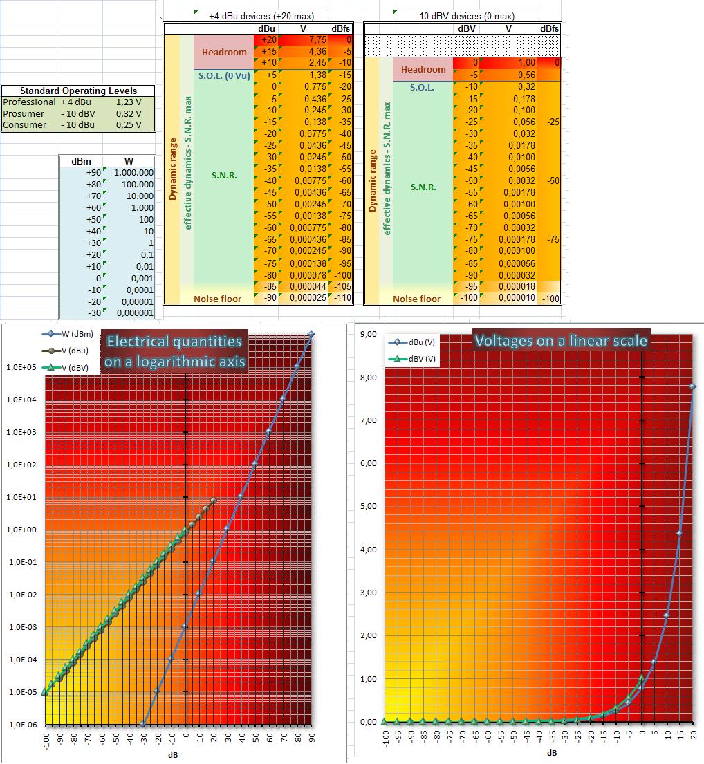

Music and audio practise (...and theory of course, above all), lately have ended up occupying a very little amount of my time.
It's since a couple of weeks I feel the need of recall back and reinforce that some of basic knowledge I had about, with the aim of disperse the thin mist in which It looks like I move, when it comes the time of making music.
Actually, I started putting some order in physical and virtual stuff in my room and hdds; then I went on revising basic concepts like equations and logarithms, electrotechnical priciples, transfer functions... At now I'm back on Audio Technical basics; in these days i was on the specific subjects of Operating Levels and Dynamics. While on these subjects, my mind was drawn back to this thread on PlanetZ, since here it was the last time I discussed these topics.
Ken, I'm sure at now you solved the issue, with the advices here, gathering other informations, ...with some trial even, and above all maybe :wink:
Nevertheless, in order to rectify something I said here, as well as in order to share my attempt to increase confidence with these things and better fix them in memory, (even in order to take a breath, a break, from formulas, theories and experimentation), I'm gonna post a speadsheet I just made about dynamic units, values, ranges and compression.
The second-last table calculates the out values for a compressor at given threeshold/ratio; it doesn't include the make-up gain ...but it should be a simple sum to the out values.
The last table is kind of a calculation tool for the compression/limiting of dynamic ranges: at a given amount of attenuation it returns compression ratios at relative threshold levels ...to experiment with.

In your specific case,
kensuguru wrote:oops, sorry, this is for live. Ya, for recording I wouldn't mess with the signal on the way in.. Just for live I want to do a bit of compressing to keep the vocals from bopping in and out of the mix when the vocalist's alignment changes.
the second-last table should had been more usefull in order to display the corresponding level difference between quiet and loud peaks, at in and out; I'm thinking about kind of a specific algorithm for this, since various values of ratio have to be tried to find the right values at the output... but...it was at first intended just to better familiarize with basic compressors behaviour... numerically, of course; the audible result of different compression ratios and threesholds is another subject: transients and attack time, coloration, release time...

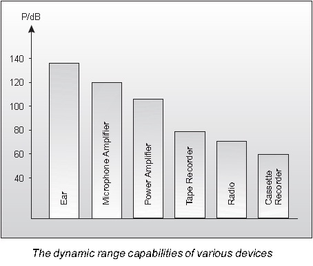

it just entered my mind while looking at the last table...
As dB is a logarithmic scale the proportions are rather unfortunate, but that's just a minor.
The funny thing is that we're pleased to be fooled time and again by this huge 'processing' range of the ear.
Actually it's complete BS or does anyone actually hear a 12dB whisper right after standing next to an aircraft engine :P
We need time to recover or 'adjustment', just like any amp :D
(strange that I never noticed this before)

astroman wrote:it just entered my mind while looking at the last table...
all excellent points, yes that graph should look crazier, and no, no transducer is expect to use 140bd of dynamic range in any single event, not even the human ear. obviously, the noise floor in the head is very low and theres some kinda noise cancellation network involved for bloodflow...
Of course, that's right.
Besides, a classical music "fortissimo" should be around 95 dBspl. Almost every 24 bit AD converter could handle that as peak value, even setting dBspl=dBfs...
That table is just taken from the "basic knowledge" section of the user manual of a device from a manufacturer of audio equipment producing hardware compressors, limiters, expanders, gates, among the others...
